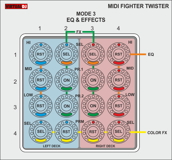

MODE 3 - EQ & EFFECTS
In this mode you can control the 3-Band Equalizer (or Stems depending on the EQ Mode), Effect Slot 1 and Color FX for Left/Right Decks.
KEY
ROTATE
PUSH
3-Band EQ
ENC_1_1/1_4
Eq High
Reset EQ High
ENC_2_1/2_4
Eq Mid
Reset EQ Mid
ENC_3_1/3_4
Eq Low
Reset EQ High
FX Slot 1
ENC_1-2/1_3
FX Select when in select mode
FX select mode toggle
ENC_2_2/2_3
FX Param 1
FX On/Off
ENC_3_2/3_3
FX Param 2
FX On/Off
Color FX
ENC_4_1/4_4
Select Color FX when in Select mode
Color FX Select mode toggle
ENC_4_2/4_3
Adjust Color FX
Reset Color FX (mid position)
