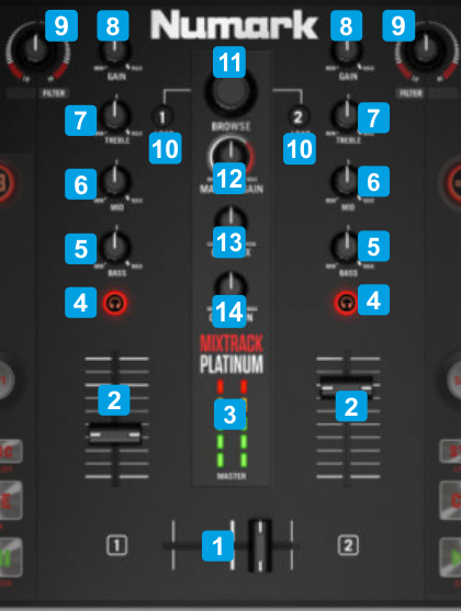

MIXER & BROWSER CONTROLS
KEY
ACTION
SHIFT (SECONDARY) ACTION
S SHIFT
Press this button down to access secondary actions as described in the SHIFT ACTION column
1 CROSSFADER
Blends audio signal from the decks assigned as left and right sides of the crossfader.
Assign buttons are available in the 4 Decks Layout of the VirtualDJ skin
2 VOLUME
Adjust the Volume of the Left and Right assigned Decks
Starts playback of Left or Right assigned Decks when the fader is moved from the minimum (low) position to a different one and stops to Cue position when moved from any position to the minimum (Fader Start/Stop)
3 VU METERS
The LED array indicates the pre-fader Level Output of the Left and Right assigned Decks
4 PFL
Send the pre-fader audio signal of the Left and Right assigned Decks to the Headphones channel (for pre-listening)
5 BASS
Adjust the Low (Bass) Equalizer Band of the Left and Right assigned Decks
6 MID
Adjust the Mid (Middle) Equalizer Band of the Left and Right assigned Decks
7 TREBLE
Adjust the High (Treble) Equalizer Band of the Left and Right assigned Decks
8 GAIN
Adjust the pre-fader Volume (Gain) of the Left and Right assigned Decks
9 FILTER
Applies a High/Low Pass Filter to the Left and Right assigned Decks. Filter is not applied if the knob is at the middle (12 o'clock) position
10 LOAD
Loads the selected track from the Browser to the Left/Right assigned Deck
Unloads the same Left/Right assigned Deck
11 BROWSE
Scrolls through Folders or Tracks
Push to toggle focus between Folders and Songs List
Set focus to Folders list. If focus is in Folders list, expand collapse sub-folders
12 MASTER GAIN
Adjust the Level of the Master Output
13 CUE MIX
Send audio signal from the Master Output to the Headphones channel when in maximum (right) position.
Send audio signal from the Decks that have their PFL enabled to the Headphones channel when in minimum (left) position.
Blends the above audio signals when in all other positions.
14 CUE GAIN
Adjust the Level of the Headphones Output Channel
