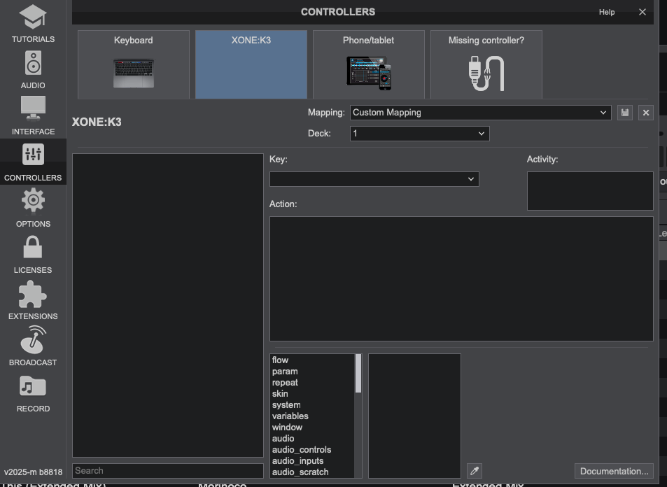

I’m new to Virtual DJ. I hade and Allen and Heath K3 controller. I can map buttons to play/ pause, cue, faders for volume etc.
what I’m struggling with is sending MIDI commands back to the controller to light the button LEDs. I can do this with Rekordbox but so far not managed. I’ve read loads of posts but feel I’m missing a step. I’ve got an app monitoring MIDI but it isn’t seeing anything from Virtual DJ.
Please point me in the right direction. Once I’ve got 1 led working I will be fine with the rest.

Xone K3 is natively supported in VirtualDJ https://www.virtualdj.com/manuals/hardware/allenheath/k3/setup.html
No need to do any Mapping. Complete Manual is in works, but you can check the functionality from the K2 Manual, its pretty much the same.
Just make sure you are using the latest version of VirtualDJ and disableBuiltinDefinitions setting is set to No in VDJ Options

Thanks for the reply. How do I delete the custom mapping I have created and use the built in one?

Normally you dont need to. I mean probably before adding support, the device was detected as "simple Midi" and so would be your custom mapping named.
But once you open the latest Build of VDJ, and get the device properly named and detected, you should get "Factory Default" Mapping in the drop list in Controllers.
You dont get that ?

No not sure what has happened but the Xone:K3 mapping is empty
I have installed the lasted version of the software and disableBuiltinDefinitions setting is set to No

So at the very bottom of the LICENSES tab, you read ..
VirtualDJ Build 8818.2187 ?
Do you have any other apps running that could work as a bridge and block the K3 from workingas MIDI device in VDJ ? Perhaps the Xone Editor ?
You could also provide some logs to check.
In your VirtualDJ HomeFolder, open the systemreport.txt and post here its content.

Yes that is the build.
--- VirtualDJ System Report --- 850.8818.mac --- 2025-11-28 17:01 ---
-- System info --
CPU: Apple M1 Max
Stems GPU: GPU (Apple M1 Max)
GPU: Apple M1 Max
Memory: 32768 MB
-- MIDI Devices --
Midi in device: interface="XONE:K3" port="XONE:K3"
Midi out device: interface="XONE:K3" port="XONE:K3"

Does the Xone K3 need to be on the default / factory Midi channel as it is on 1
