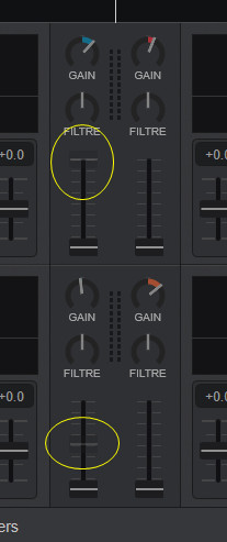

I have a Denon MCX8000 with 4 faders (3-1-2-4) that work correctly.
When all faders are down on the MCX8000 and I connect it to VDJ :
- The 2 faders on the left (3-1) are up => abnormal. Work only with VDJ.
- The 2 faders on the right (2-4) are down => normal. Work with VDJ & Denon
When I move down the faders 3-1, I can see on VDJ, kind of "shadow" faders that could explain the issue I have.
How can we fix the issue ? Is there a mapping to check / modify ?
Thanks

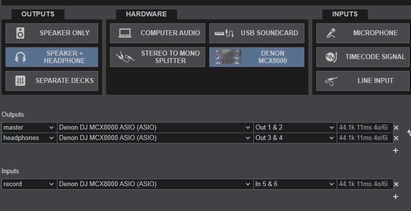

Thanks for your answer.
It happends all the time, whatever if I start VDJ or Denon first.
If I use the pro-layout of the default skin, only the 3-1 volume faders don't work (all other faders or potards work).

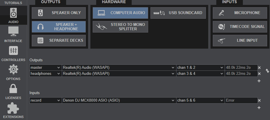

My current outputs settings are these ones below

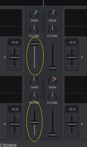

If I play a track on deck 3 or 1, I have to control the volume directly with VDJ (no action with the Denon fader), and I have no information about the track on the screen for the left side of the MCX8000 (only "Denon DJ MCX8000").
When I move the 3-1 faders on the Denon, it moves very slightly on VDJ, as if it were ‘frozen’ or blocked by a setting. That's why I'm surprised to see these kinds of ‘shadow’ faders on my previous screenshot.
I confirm that all of these faders adjust the volume correctly without VDJ.

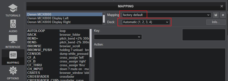

Let's first try to see if we all have the same starting point.
- All 4 Input Select switches are at PC at the top mixer panel
- Use the default Audio setup
- Use the Factory default Mapping.
- Use the default 4 Decks Pro layout skin to see all 4 Mixer Channels
For VirtualDJ normally shouldn't matter the Build - nothing is changed in between - but proffered to use the current Public one.
Do you see get the same issue with the above ?

BTW, i just tested with Build 8741 and everything works as expected incl Vol Faders init positions.
ASIO Driver, Firmware to the latest version., default Audio setup, Default Mapping and default Deck Assign (1,2,3,4)
Also did a "Factory Default" reset - just in case a setting was set differently here - by entering the UTILITIES Menu

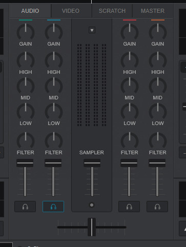

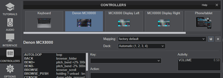

Hi,
- I didn't have a crash with VDJ or Windows.
- I always launch VDJ manually.
- I have an Internet browser open.
If I disconnect the MCX8000, I use the default audio configuration, the default mapping, the default pro 4-deck skin.
After restarting VDJ, so I have the result below (and I don't see "shadow" faders for the 3-1.
Posted Thu 18 Sep 25 @ 6:49 pm
If I reconnect after the Denon, I have the same issue as before with the 2 faders
