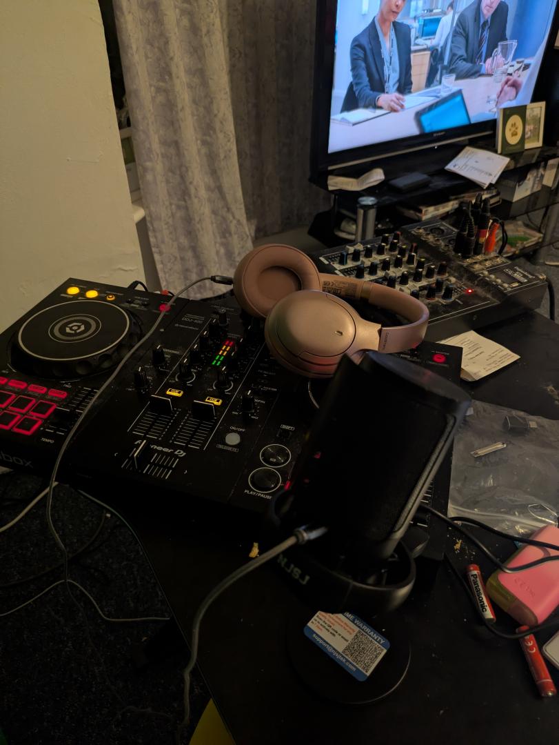

hi i'm having problems with my mic its a ME6s mic
i'v got a pioneer dj ddj-400
now i'v got my mic plugged into a usb hub
my headphones in the mic socket everytime i broadcast
i get this wierd echo? wondering if there's a setting to turn it off?
both mic and mixer attacted

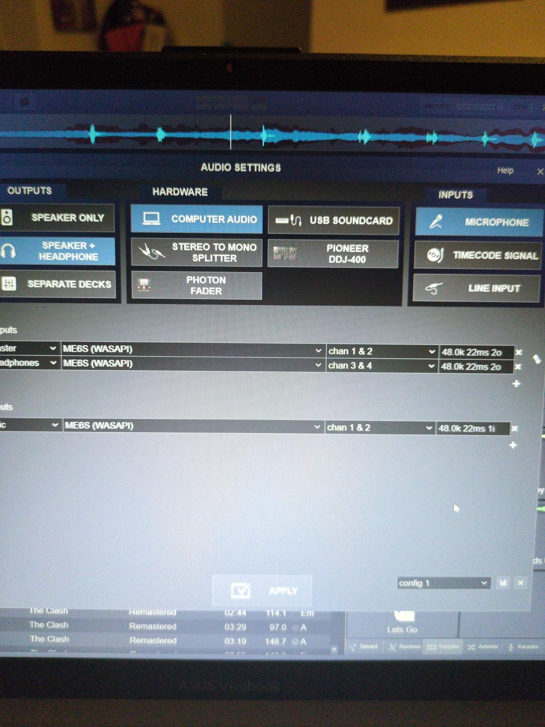

settings attached as well
i want to be able to
have headphones in mixer hear the music, and not music going through laptop speakers
i want to be able to hear the mic through headphones as well (considering mic not echo's?)

It's most likely not an echo but latency, which will sound like a latency if you listen to the processed input in real time. And you most likely need to buy a soundcard that's meant for recording to get a latency so close to 0 that you won't notice it, and then install and configure the correct drivers for it.
I personally use a relatively cheap Focusrite Scarlett 2i2 for those type of situations

'i appreciate the input, but Is there anything I can do in either virtual or sound settings
Posted Tue 26 Aug 25 @ 8:45 am
He's already given you one possible solution.
IMO you should have spent your £25 on a standard analogue mic with a jack plug, and connect it directly to your DDJ-400. Cheap USB mics will likely all have similar issues.

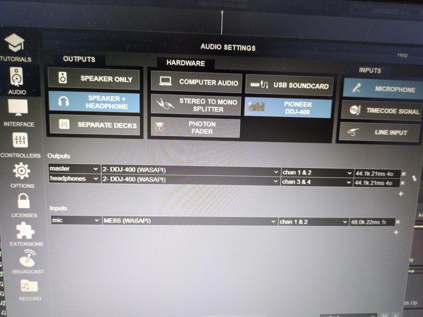

If the ME6S is your mic, I don't understand why you would be sending the master and cue outputs to the mic in your audio settings. The DDJ-400 is plug and play, with native support. Use the default settings.

Rite what's the default I'll try that?
Posted Tue 26 Aug 25 @ 9:07 am
The default is what appears on the screen when you plug in your DDJ-400. VDJ detects it and asks if you want to use it. The default is also shown on the audio settings page (in your picture). Click the button.
The default is also shown in the VDJ setup guide for the DDJ-400.
Posted Tue 26 Aug 25 @ 9:14 am
My settings are set to default

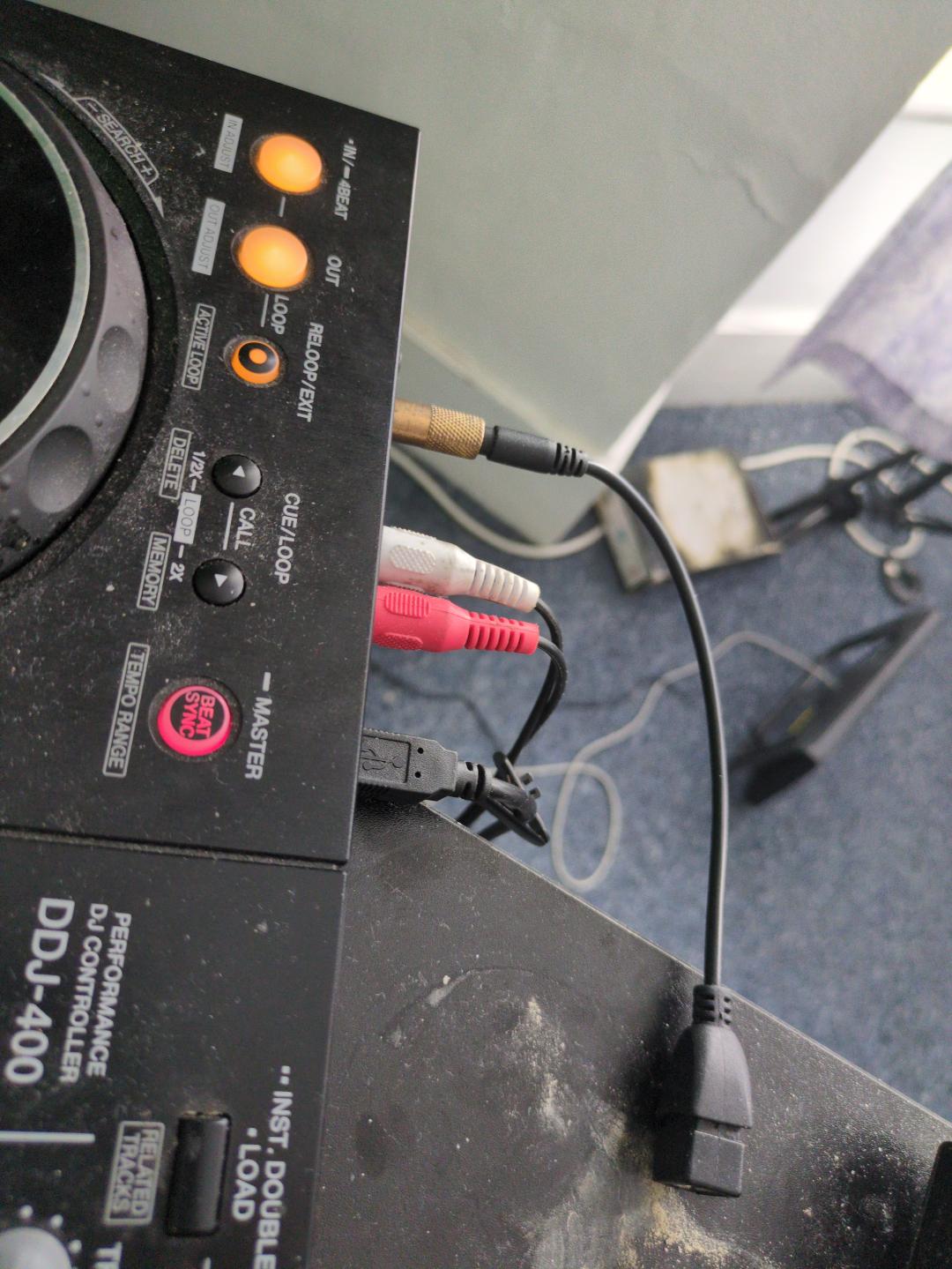

Got da usb connected to
The back as well. Yet mic don't work In there
For some reason
For some reason
Posted Tue 26 Aug 25 @ 9:46 am
Presumably "da usb" is a cable adapter that comes with the ME6S? It's probably designed to be plugged into the mic input of a computer, which can provide "plug-in power" (PiP) for condenser mics.
DJ mic inputs don't have any power. They're not designed for USB mics or any kind of mic that requires power.
As already stated, you need a standard analogue (dynamic) microphone with a 6.3mm jack plug.
Posted Tue 26 Aug 25 @ 10:18 am
