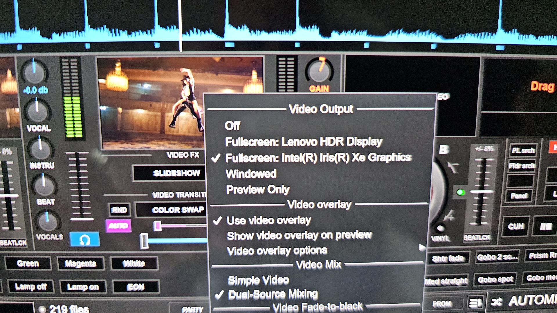

I'm trying out a multiple monitor setup and it's causing issues as they are all different resolutions. If I duplicate 2 & 3 Windows keeps reverting them to separate displays for some reason.
Is it possible to output the VDJ video to more than one separate display?

Only if you edit a skin and add a video panel at the right side.
What are the resolutions of the monitors (incl your laptop's one) ?
That's a problem u need to investigate further

Hi Babis,
Was just messing around with a friends dual screen laptop. The inbuilt second display is 16:9 and the monitor on the front is 16:10 so there's a conflict. Turns out the issue is the Lenovo dual screen software manager. Everything works fine with Windows itself but with the Lenovo service running it keeps splitting them apart from being extended. Problem is you need that Lenovo service for everything else the laptop does with the dual screens.
No biggie, also answers my question regarding separate video outputs in VDJ.
Thank you!
Thank you!

The Blocks skin you use (i believe) has an extra Video output window that you could drag to the 2nd ext monitor and resize to fit , no easy maximize though.
Posted 3 days ago @ 5:11 pm
Ah OK, where in the skin do I find that? Thanks!
Posted 3 days ago @ 5:19 pm
Ah if you use the 2 Decks Video layout, it's not there. Send me your modified skin to add it.
Posted 3 days ago @ 5:23 pm
OK, will do. Thanks!
