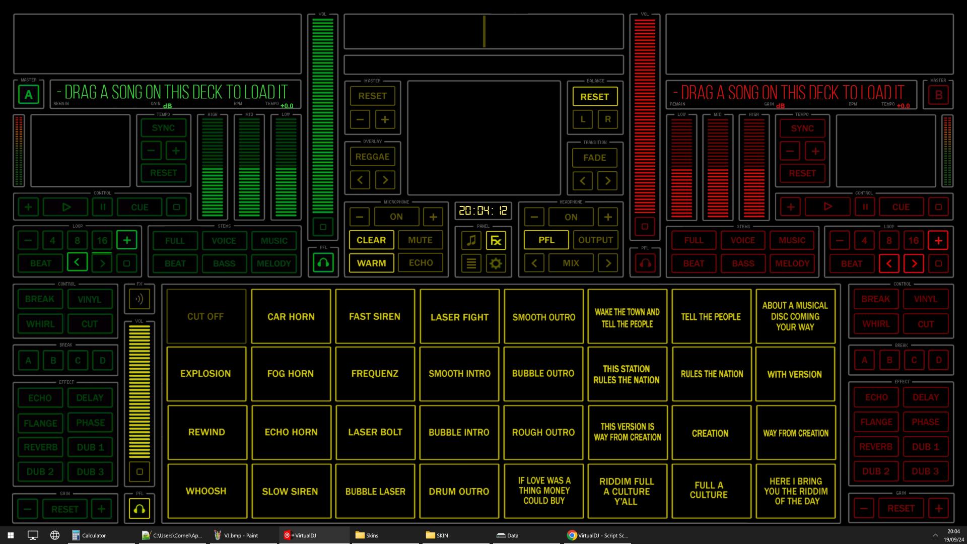

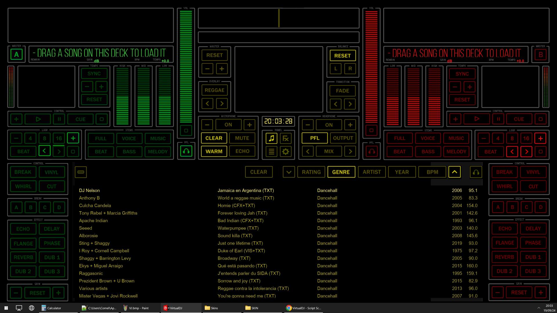

What I get while changing the center panels (which take up to a second to fully load with the correct graphics) in my skin is random 'filler' graphics (grey) and missing lines, like this:
LOADING
LOADED
LOADING
LOADED

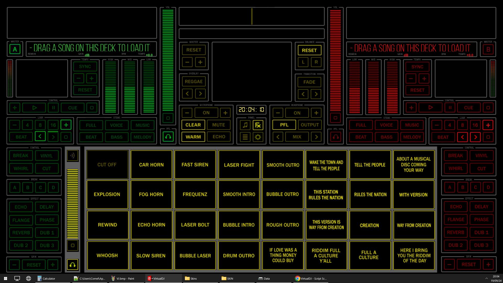

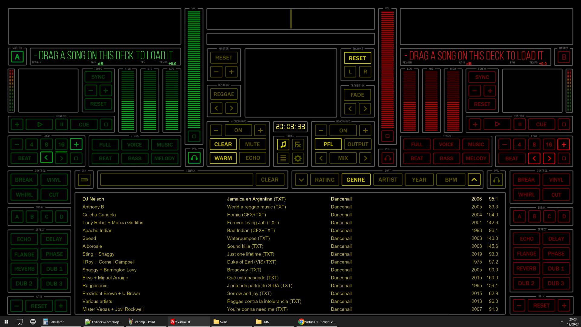

Here's another panel:
LOADING
LOADED
LOADING
LOADED

What do you mean with coordinates outside the skin boundaries?
You mean outside of the 1920 x 1080? Any changing graphic would always and necessarily be outside of the visible area...
Posted 6 days ago @ 9:37 am
@ADION
"a bit more strict in size definitions"
Please elaborate. What am I doing wrong with my size defs?
Posted 6 days ago @ 9:39 am
I don't know, since I don't know the contents of the panel, but in general, you have for example
So in this case, all the elements inside should fit within (245, 594) -> (1672, 1075)
<panel name="SESSION" visible="var '$MAINPANEL' 3">
<size width="1427" height="481"/>
<pos x="245" y="594"/>
