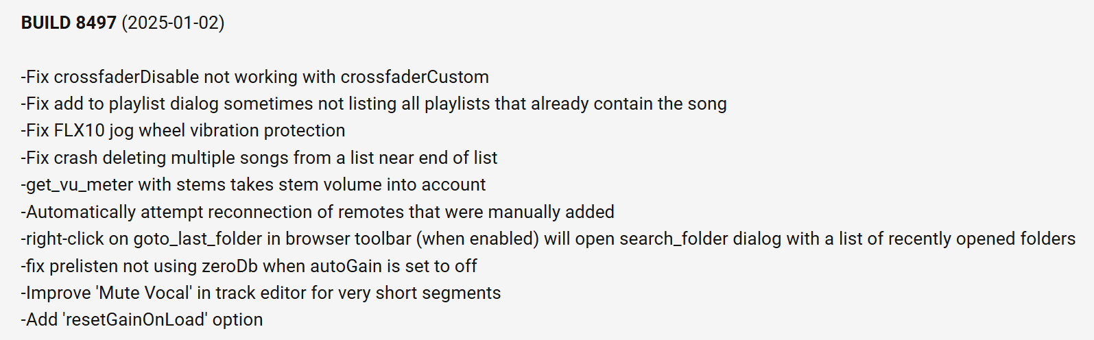

Please note the post from djdad in the thread mentioned by kradcliffe:
djdad wrote :
There is a hardware vibration protection in MIDI protocol of the FLX10 (usedby VirtualDJ and Serato), which was causing this "dead" operation in slow jog movements.
In next update, VDJ will be using the HID mode for Jogs (used also in RB), so you wont get this issue.
EDIT. Actually we forced this change in current Early Access Build 8314. It's a silent update, so you need to restart your EA twice to get this. In the LICENSES tab, you should get Build 8314.2099
