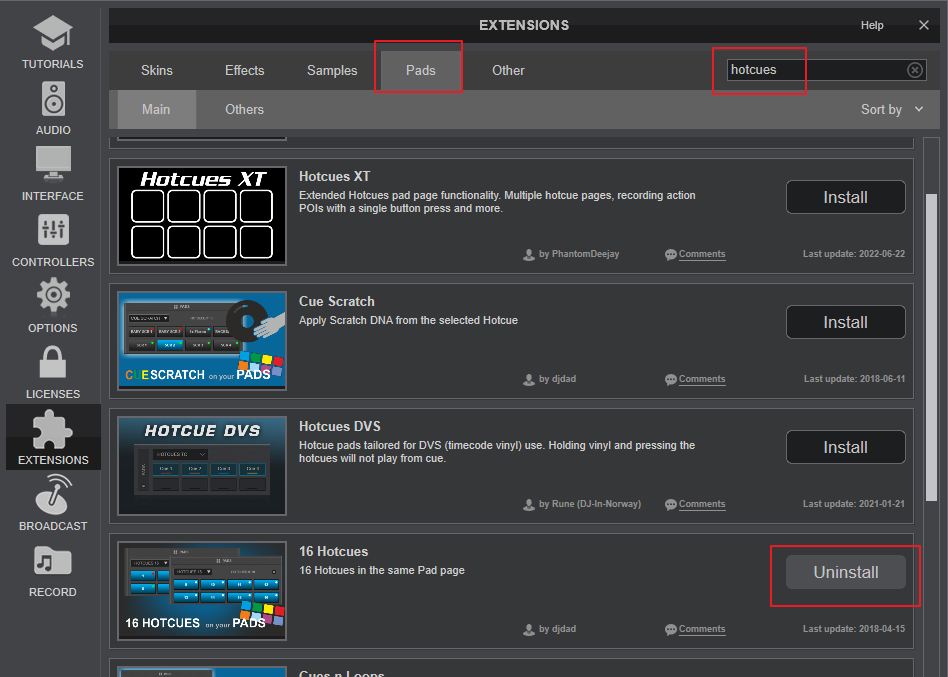

- Open VirtualDJ , goto Settings->EXTENSIONS and install the Hotcues 16 Pads page..

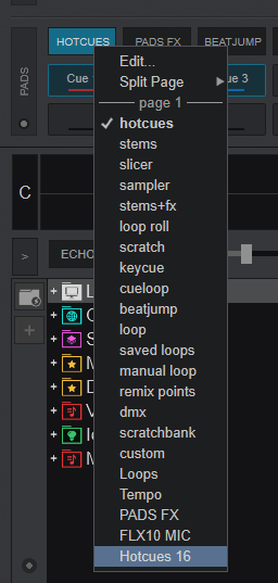

- then with the FLX10 connected, right-click on the 1st mode button (HOTCUES) on the skin and select the new installed Hotcues 16 page.
From that moment, each time you press the HOTCUE button on the FLX10, the 16 Hotcues page will be loaded instead of the default, and the 2 Param buttons will toggle between the 2 Banks.
