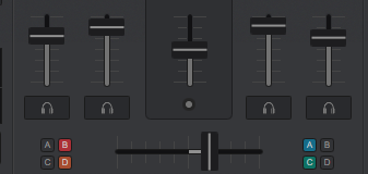

Hello everyone.
I just bought a mixon 8 pro and I have a major problem.
This comes from the crossfader assignment with switches A thru B
I specify that I did not modify anything on the mapping.
Basically when the switch is on A on decks 1 and 3 the crossfader does not work and when the switch is on B it works
The same phenomenon occurs on all decks, basically all decks are assigned to switch B
I looked for a script to correctly assign the switches to each position but nothing,,,,,I fail.
As a result, my crossfader is unusable.
Thank you for your help :)

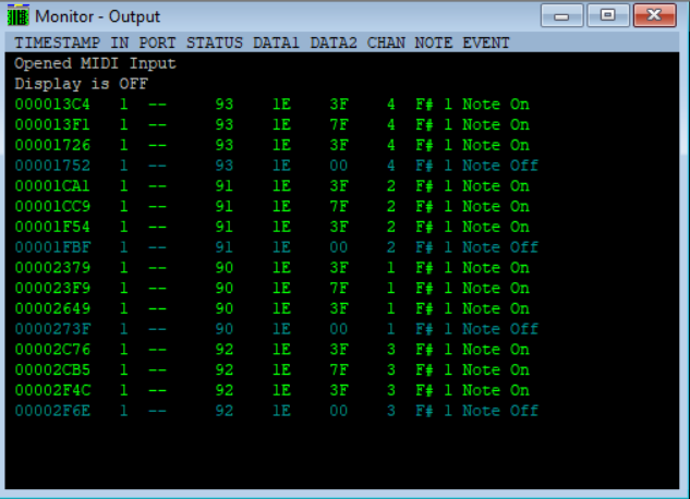

hello IIDEEJAYII
TEST:
1) i switch the cross assign and i can read this:
cross_assign left off
cross_assign thru on
cross assign right on
2) In serato and djay pro everything work fine.
3) I do the test with Midi-Ox, left not working, i join a screen capture.
POSSIBLE CAUSE:
A) I don't think it's come from the hardware, it's occur only in virtual.
B) Firmware is up to date with the last version (V50.39 Windows)
C) Like you said, virtual definition may have a problem and a tweak can resolve that>
Posted Wed 17 Apr 24 @ 4:46 pm

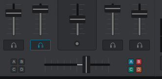

Hello DjDad.
The mapping is set to factory default, i've tried to change the deck order, problem still present.
I can set propelly the cross_assign in pro skin but manual and when i close and start virtual the problem still there, that not the idea to set each time manually the cross_assign ;)
I join screen capture :)

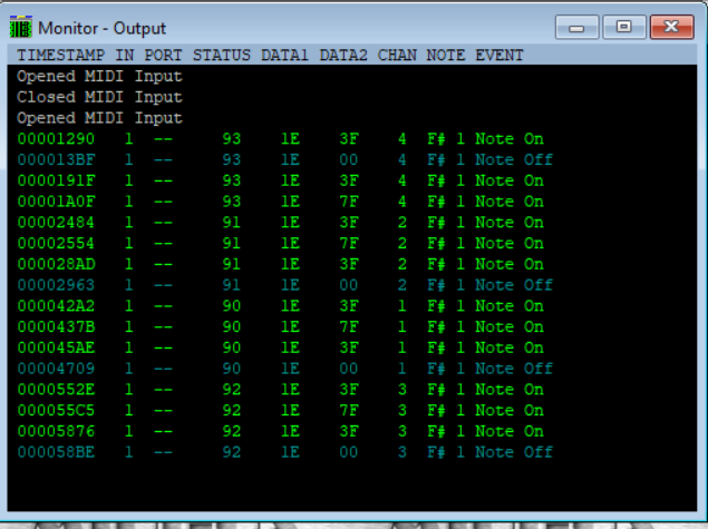

Hello.
I've tried to get more fine results from midi-OX but l am not use to this software.
Maybe there's some others settings to get more results about switches positions?
So, i made an another test with serato and djay pro with midi-ox, i get the same results in the display output like in virtual but the cross_assign work well without any trouble in booth software. (i join a screen capture)
Sorry if i didn't explain well the first midi-ox test, this is only for virtual.
Like you said, all my tests points to problem of definition, i don't see an another explanation :)
Posted Fri 19 Apr 24 @ 5:44 pm

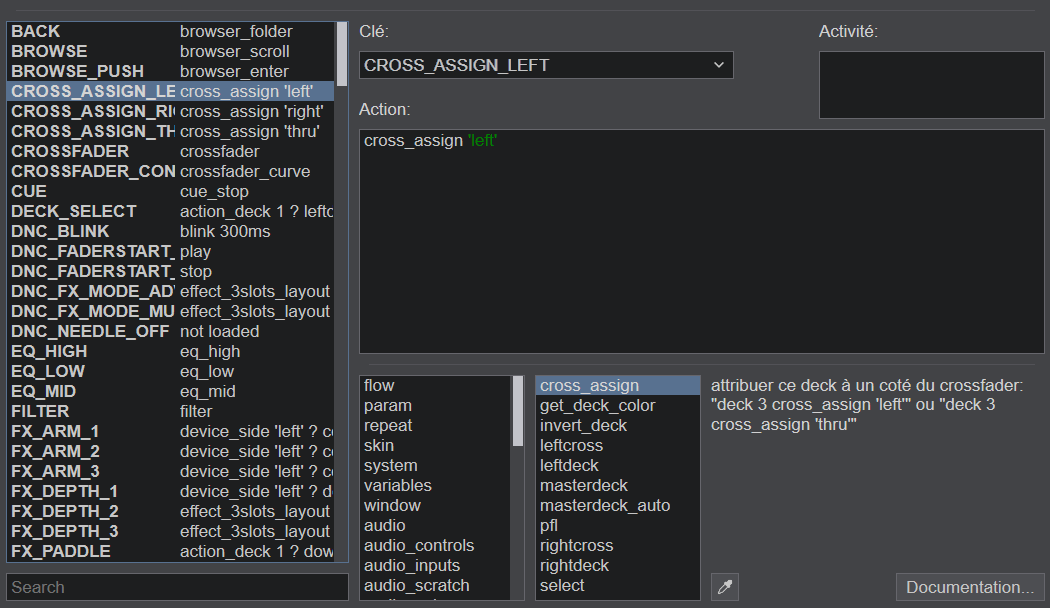

Hello.
I always djing with the "hamster" mode, this is correct. :)
About to set a ONINT to map correctly the cross_assign function, it could be resolve the problem....
But I'm not really sure how to set this function correctly, can help me to set that it will be great :)
Posted Fri 19 Apr 24 @ 5:52 pm
