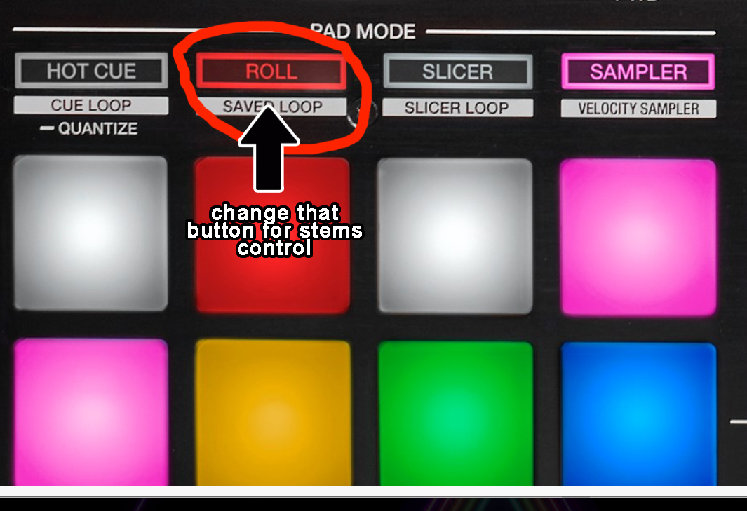

Is there a way I can change the Pad Mode "ROLL" option to "STEMS"? I only use the Pad Mode for "HOTCUE" and I'd like to switch between "HOTCUE" and to "STEMS" using those buttons instead of having to go to my Macbook and change it there.

I dont get it..
How do I replace the "Roll" button to "Stem" ?

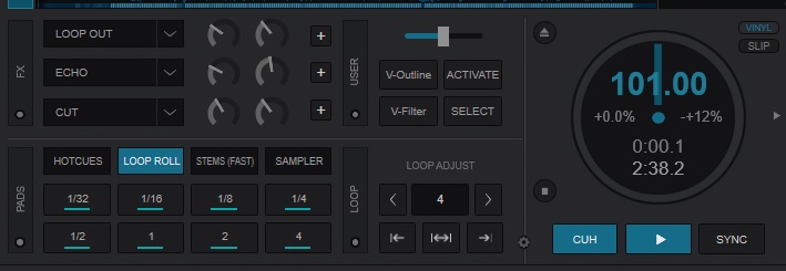

It worked dude. So I use the first bank for my "hotcues" and then when I want to use "stems", I just hit the "roll" button and instead of getting "roll" effects (whatever that is) the buttons are now used for "stems"; vocal, instrument, kick, hi hat, etc. after I blend in the song I hit "hotcues" again to go back to cueing the next song.

In the pads section on the skin, open the drop-down, open the sub-menu for page 2: roll for your controller, select stems.

If your controller is connected, it's just a click on the Pad page drop down menu

Do you get the menu that shows the assigned Pad pages ?
Posted Wed 11 Oct 23 @ 6:53 pm
Yes, I see them (picture)
The problem is to save it to for example "roll" button.
Stem wont stay as default after the change, dont know if it is anything with the mapping that im missing?

This is the picture..
It doesnt work to jump to stems with the slicer button on the controler.
Should this work right away when I have changed it ?
I can jump between all other padpages hotcue, looproll and sampler on the controler.
