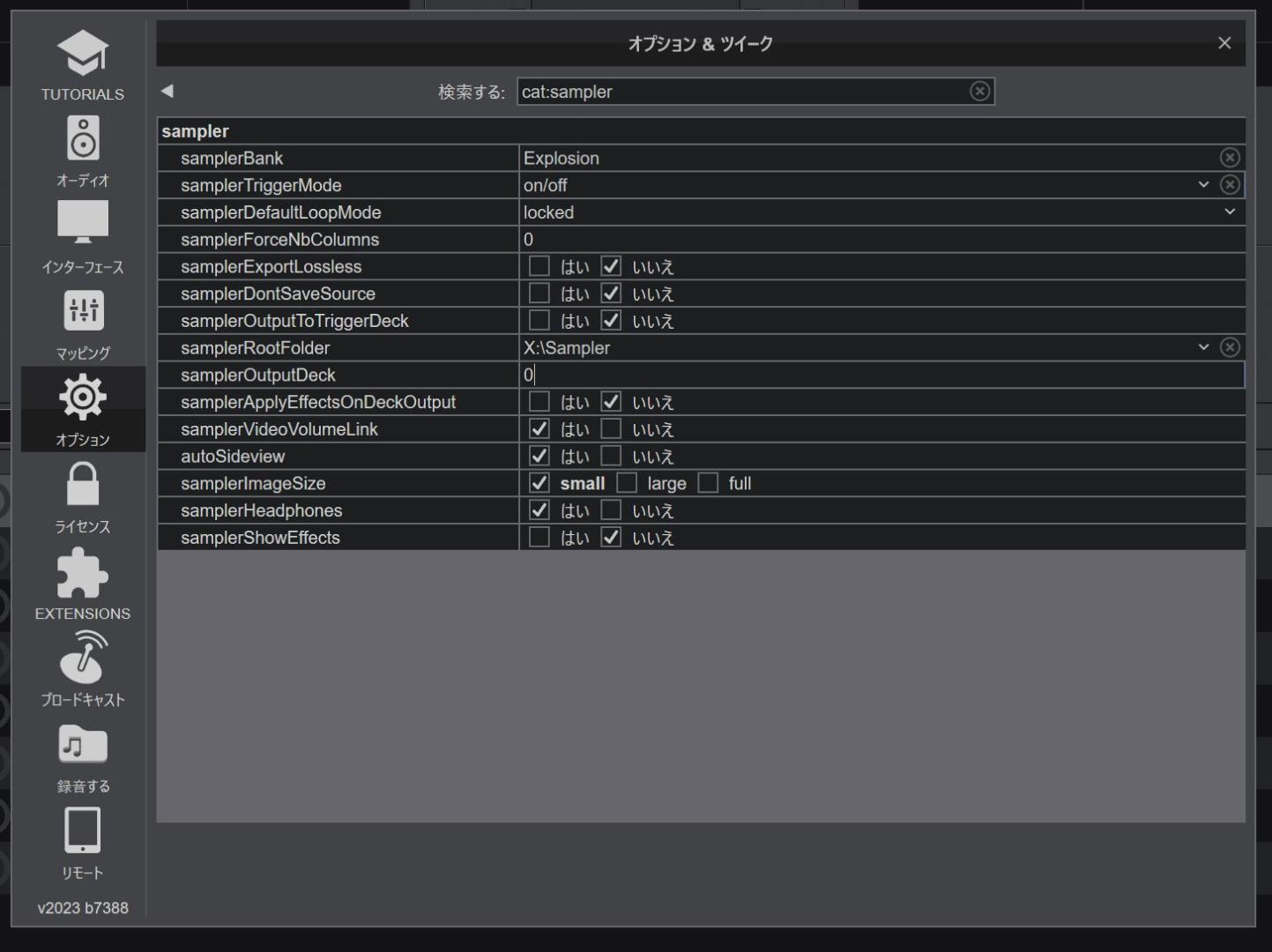

if that does not work.. post a screenshot of your Settings > Options > Sampler

This one
sampleOutputDeck is "0" (Master output),it is default.
If I play SAMPLER on DECK1, I want to stop the song on DECK1.
