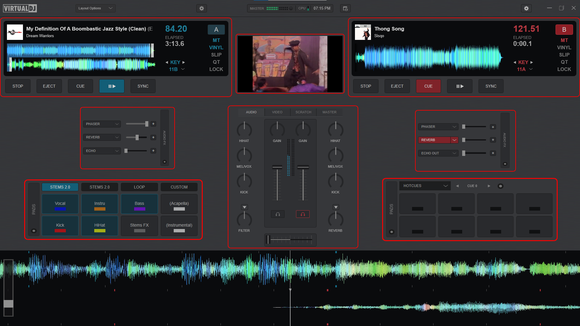

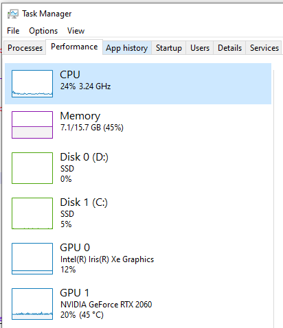

This is an example layout. Everything is running smoothly except the scrolling waveform at the bottom. Video is behaving well, there are no visual or audio issues, and although stems are set to compute in realtime there is no activity. There seems to be no stress on the CPU or either GPU...

Setting the experimental skin certainly reduced the lag on the scratchwave when using up to about six windows, a very noticable improvement!
However, my idea was to create many windows which the user could drag around and resize according to their monitor size and preferences. I think I may have to have a rethink.
I would suggest possibly up to 4 -5 different windows per deck and 4 for the master area. Using four decks could potenially mean up to 20-24 windows active at one time which is understandably not feasible.
I think I will possibly change all window elements to panels (so without the option to move and resize) and offer a few configurations for different scenarios.
