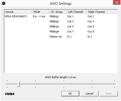

Can you post screenshots of your Audio Setup in VDJ and the ASIO Settings Control panel of your VMS4 ?
Yes, that did it. I found the answer in advanced settings section here, but I thank you very, very much for confirming it!! My owner's manual says 4 out, not 8, so that was causing the problem. I connected the controller to my laptop and disconnected it multiple times just to make sure. All is working well again. Thank you very much again for you help, Mr. DJDAD!
