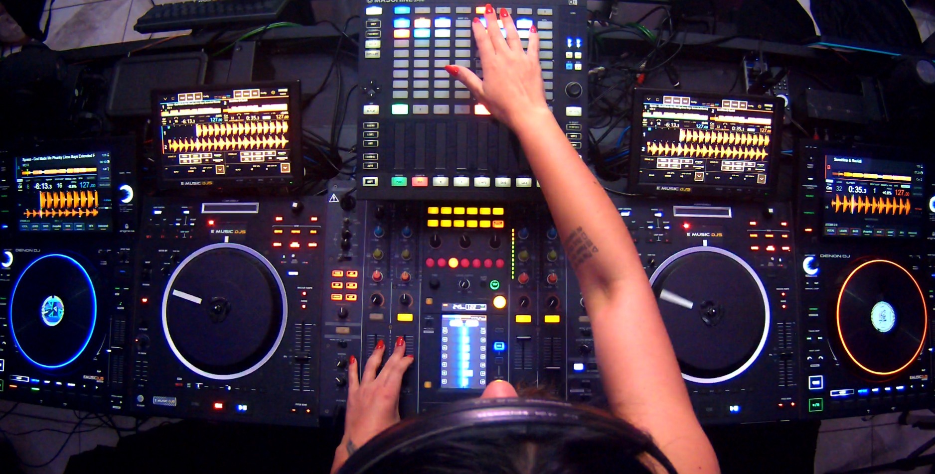

Look at the artwork in action!
Tomas Cerny (VeeJay Lizard) wrote :
Discussion about Prime 4 Modified Screen
Love it

Ahoj, mám otázku. Ako sa zapínajú 3 obrazovky ako to je na screene? (kontakty máš v správe)
(Hi, I have a question. How do you turn on 3 screens like in the screenshot?)
