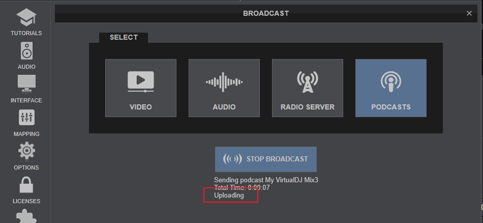

Not even before u stop ? Like this...
Posted Tue 05 Oct 21 @ 2:16 pm

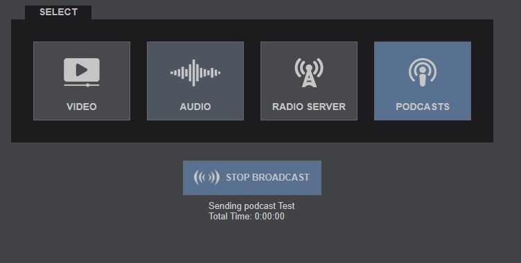

Posted Wed 06 Oct 21 @ 6:37 am
I only see this - the whole time - nothing changes, even when I stop the Podcast broadcast
Posted Wed 06 Oct 21 @ 6:41 am
