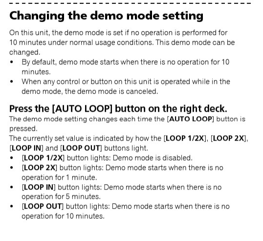

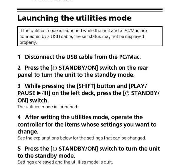

You can disable the Demo mode (what u called light show) of the SX3 from the device Utilities.
Do steps 1 to 3 from above, then do the steps you see on the following pic, and when done exit Utilities with steps 4 and 5.
Posted Mon 24 May 21 @ 3:29 am

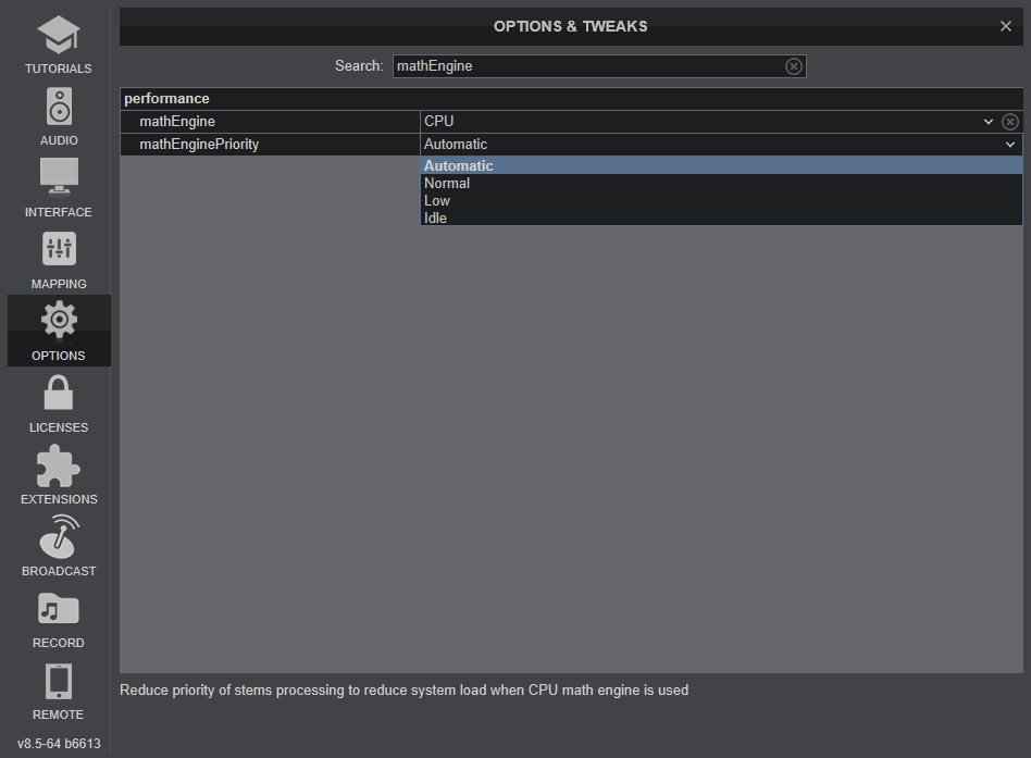

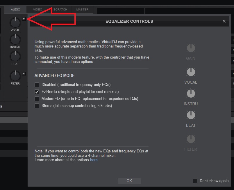

Do you have mathEngine enabled ? In that case most likely you are controlling stems instead of EQ ?
Posted Thu 26 Aug 21 @ 7:34 am

I checked the club settings and its as the pix freppa posted,
I do not use this feature so where to i set things so my EQ knobs will adjust EQ
again thanks all for helping me sort it out.
