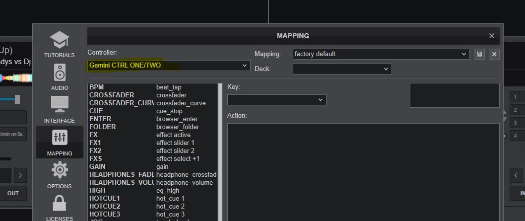

I MANAGED 2 GET MAPPING CONTROLLER MENU AS GEMINI CNTRL-2...NOW WHAT DO I DO?ANY1 HELP?IM NEW TO THIS..DO I NEED TO MAP IT MANUALLY?IF SO HOW & WHERE?
TNX IN ADVANCE
Posted Wed 26 May 21 @ 10:26 am
