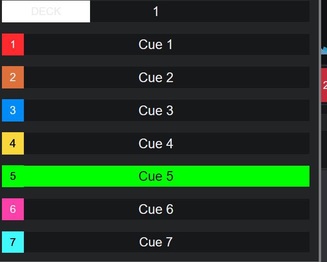

The Cuename-Panel works fine, changed the grabzone height. super...
Now I want to see, which Cuepoint is reached.
This is to orientate in the Song and know, when to play notes (written in the cuenames)
It´s kinda help for karaoke singers/players.
That for the Background color of a special cuepoint area shall change for some time.
The input for these information comes from scripts at my Launchpad.
There is an LED for each cuepoint that shows when the song is running:
8 bars before the cuepoint is reached: Color Red
4 bars before the cuepoint is reached: Color Yellow
for 4 bars from the cuepoint: Color Green
Now this info shall to be seen in the Cuelist Window (above in the last posts)
Now 2 Questions:
1. We are in a SKIN-SCRIPT.
Can [coloroff="button_background3"] changed to [coloroff="var "$d1c5""]
And "$d1c5" is "green" or color #888800 or something like this?
2. the command [set "xy..."] seems not to work on a LED but only on a button - right?
Is there maybe the color of a LED queryable? Like [LED_4.1 yellow ? play_pause : nothing] ?
Think, this will take me some time programming, and I appreciate all help
Thank You in advance
<group name="cue group 5" x="+20" y="+20+60+60+60+60+60">
<button class="button_main" x="+0" y="+0" width="600-40" height="40" textsize="24" action="cue_name 5" textaction="cue_display 5" coloroff="button_background3" textcolor="texton" rightclick="delete_cue 5" />
<visual type="color" source="cue_color 5" visibility="1" x="+0" y="+0" width="40" height="40"/>
<textzone width="40" height="40">
<text fontsize="20" color="black" align="center" format="5"/>
</textzone>
</group>
Now 2 Questions:

Thanks Locodoc, but this work is already done.
The lights are doing what they shall (thanks again to Rune)
But now (as can be read above) there is some colorchanging stuff in the cuenames-window to be done.
Till now I made controller mappings and now this is about skin...
Posted Sun 25 Apr 21 @ 8:22 pm
1 well not sure you can use a var in place of a colour but you can [coloroff="green"]
2 leds setting are queries only, the only actions they can perform is color & blink, I don't think you can query a hw led, but since it is set by a query you could just use that to determine the state.
Posted Sun 25 Apr 21 @ 8:36 pm
