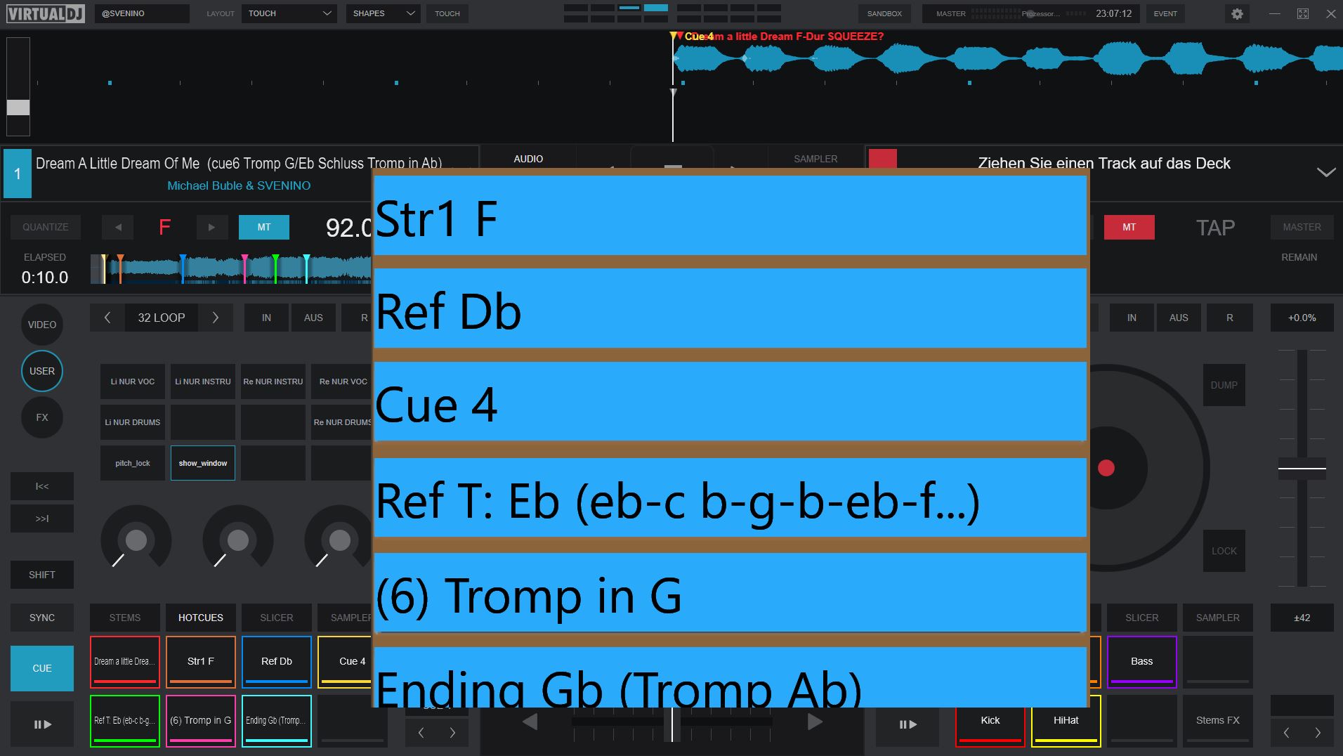

Dear LOCODOC to be honest: The last hours I tried myself and get almost a result, that maybe somebody could be interested in. I´m definetly willing to publish it, if it´s ready.
I made a floating window following Runes advise to show the cuenames of the selected deck.
It can´t be resized but moved.
BUT following issue makes me crazy:
the smaller I make the Window, the bigger the grafix become:
It´s kind of crazy, look:
this happens by using:

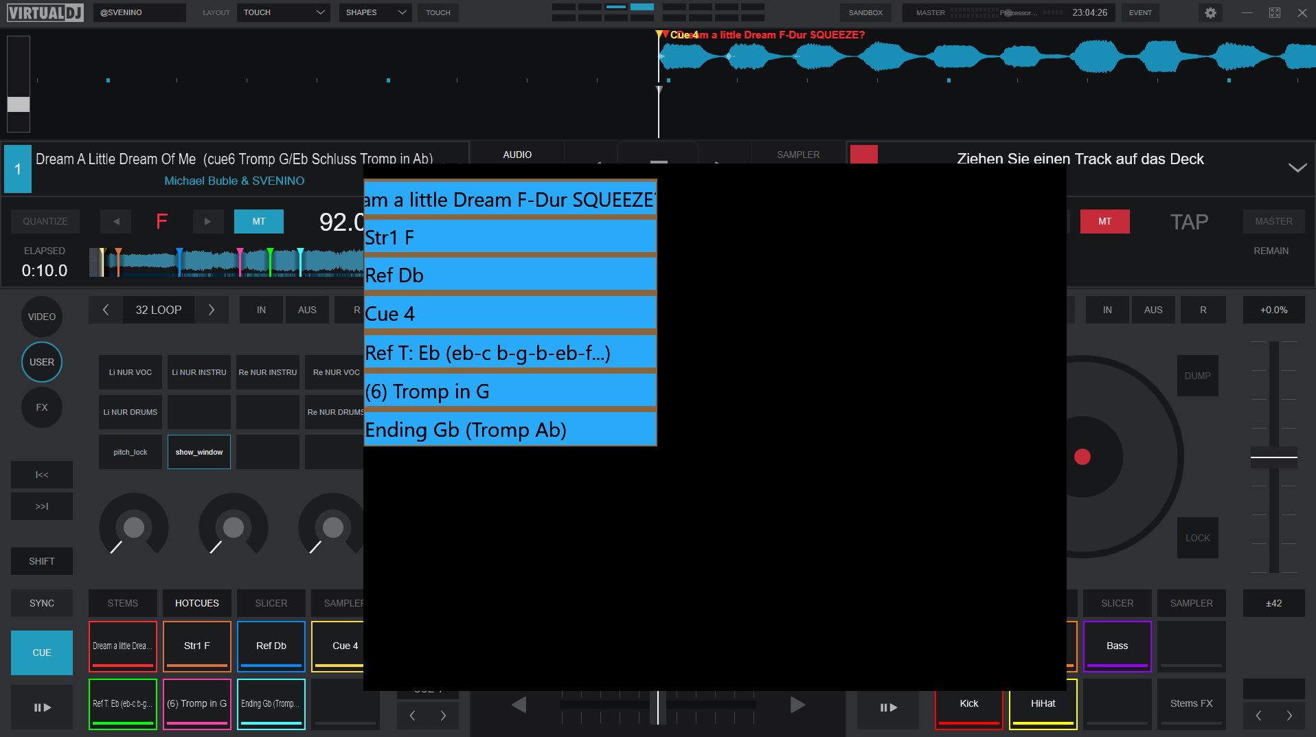

and this happens by using:
<window name="Cuenames" posx="100" posy="100" width="418" height="389" image="CNonly.png" shown="true" >
<pannel panel="cuenames" id="cuesdeck1" visible="deck 1 select">
<pos x="0" y="20"/>
<size width="418" height="389"/>
<down x="0" y="0"/>
</pannel>

<window name="Cuenames" posx="100" posy="100" width="1000" height="1000" image="CNonly.png" shown="true" >

1st window is 1000x1000 and thus auto resize to fit last size and ratio relative to main window size
2nd window is 418x389 and the panel does not fit : 418x20+389 and thus is truncated
you do not have a "grabzone" in a way to move it or a "resizezone" to resize it
("down" is here to take the image from top left of CNonly.png which must be bigger "418x389" - at least 419x390 - appear)

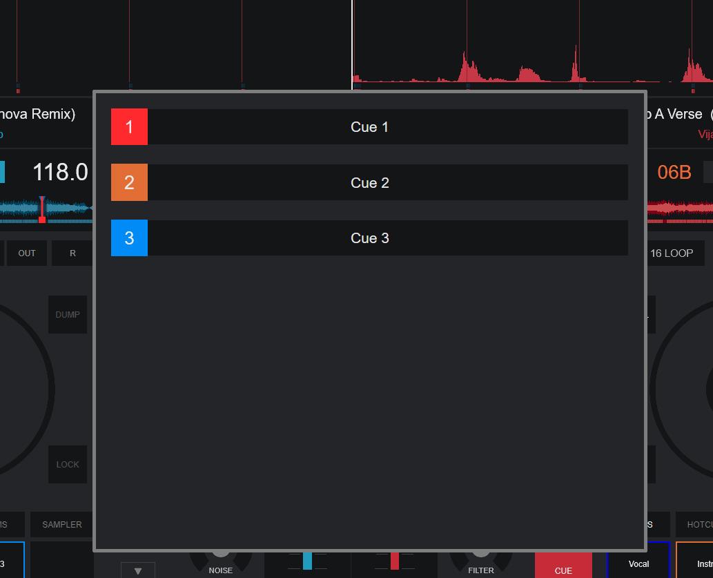

Assuming you are using the touch skin variant...
Put this at bottom of the Touch.xml skin file....
Right before the </skin> end element
I put in 3 cues for you.. but the rest should be easy...
Just copy and paste "cue group" and add Y distance +60 for each and change cue number in the actions
open/ close the window with mapping a keyboard key to : show_window 'mycues_window'

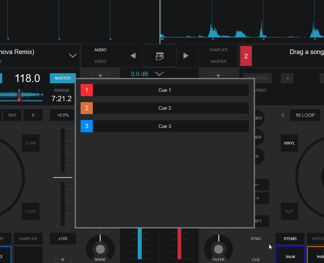

its resizable if you grab the bottom right corner (its not stretchable, but see no reason for that, already quite a large text area)

can move too ..
its a little "clunky" to find the sweet spot, but if you add <grabzone> one can make it easier
Posted Mon 19 Apr 21 @ 9:57 pm
as far as a grab zone exists, touch screen can move the window

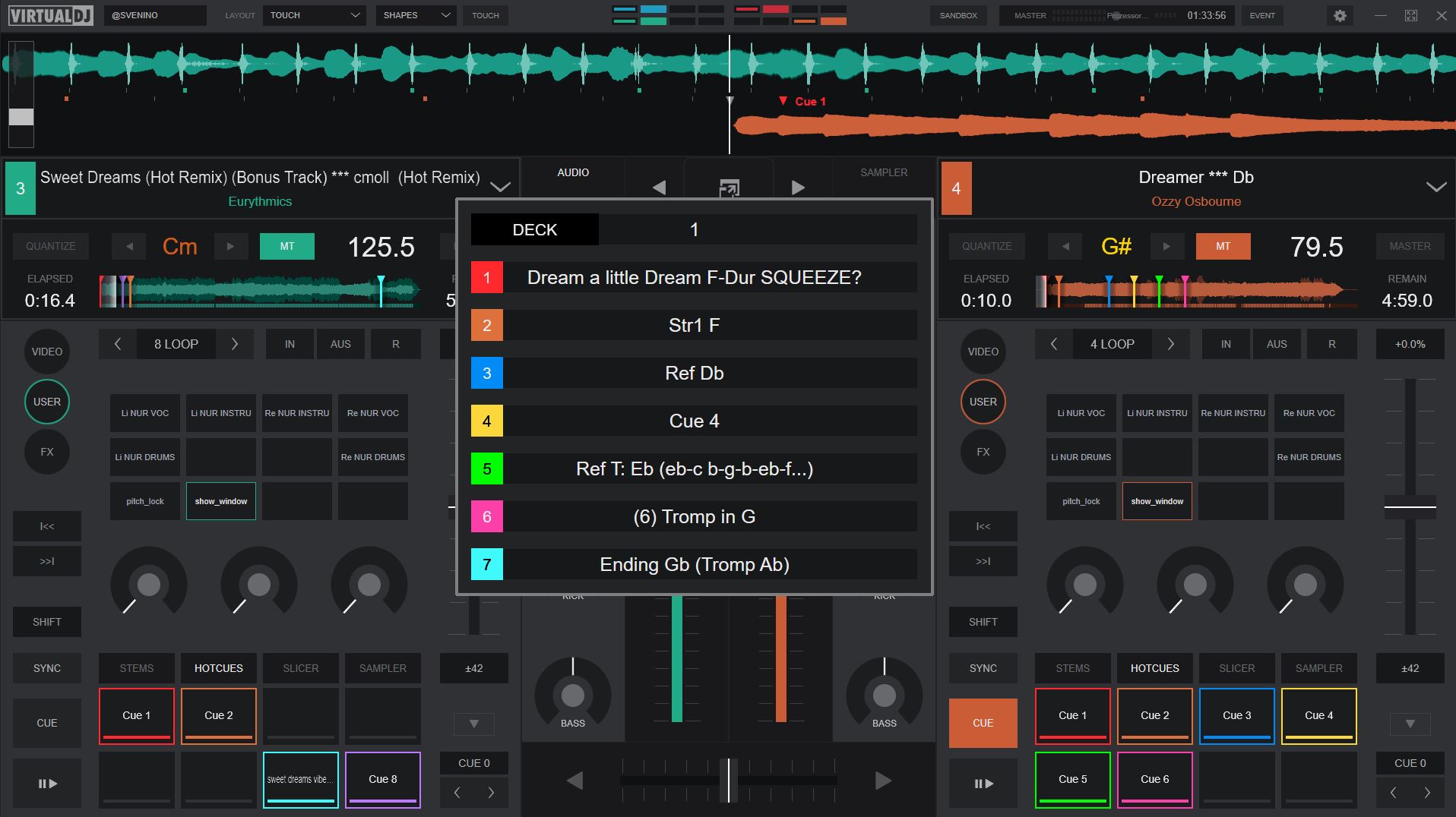

Hi Rune, this is awesome! It works - of course - because You are a Pro!!!
How long did it take You?
It really took me 3 hours to get in the language and then I failed!
This is much lost time! So may be next time I just ask for help and wait instead of fooling around with half-knowledge :-(
But of course: Thank You all gettin into my stuff!

As you can see from the time, I don't give up that easily.
Thanks to You, I made the following:
which works with these lines at the end of the skin (haunting pro...)
