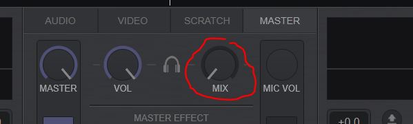

If so, check "headphone mix" that adjust the amount if how much the master sound should mix in

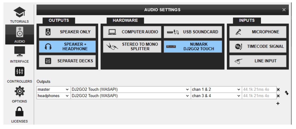

https://www.virtualdj.com/manuals/hardware/numark/dj2go2touch/setup.html
Posted Sun 21 Mar 21 @ 11:32 pm
I have the audio setup exactly like the manual and the cue mix volume is off. Still getting audio on the live track coming on the speakers when I cue my next track. Thanks.

Sounds like your audio config is wrong
Make sure it looks like it does in the VDJ manual for the unit:
The manual:

Hi, thanks for the swift reply. Unfortanetly these are the current settings I use. The problem is that the headphone toggles override the master. Even if the crossfader is all the way to deck 1 if I push the headphone toggle for deck 2 it will play through master as well. Also pushing the headphone toggle on the controller will make the track playing on the deck sound louder on master.
Putting my headphones directly in the my laptop and playing master via the controller to the speakers solves the issue and makes the headpohnes act 'normally'.
Again I validated with Serato that it is not a harware issue.

host a picture of your audio config.

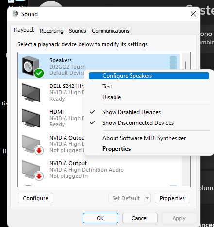

Perhaps the DJ2GO audio device is not set as 4 speakers
Open Windows Sound, right-click on the device, choose Configure Speakers and in the next window, choose 4 speakers (quadrophonic) or 3.1 surround.
Try the "Test" button there, to see if all 4 channels are working properly.

Also, your computer has to be set to STEREO. Thats what fixed it for me tonight.
