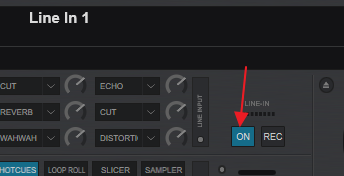

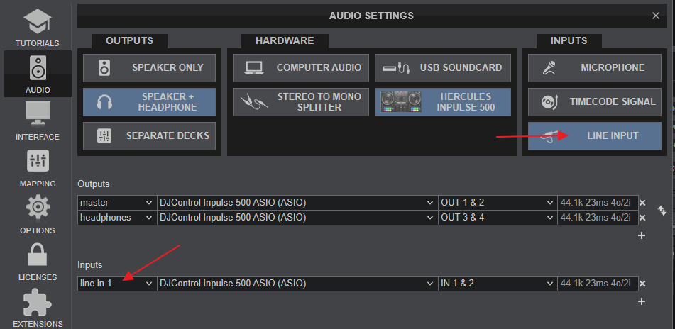

Normally the AUX input will be routed directly to the Master Output. But if you want to record/broadcast it or apply Effects etc, you need to ...
- Follow the instructions and set HardwareMicAux to No https://www.virtualdj.com/manuals/hardware/hercules/inpulse500/inputs.html
- Change the "mic" input to "linein"
- Choose a Deck to route Line Input and press the ON button.

Hi DjDad
I have the settings as in the top photo but not seeing the options shown in the second photo

The 2nd screenshot is from the default skin (Pro Layout) . Click on the vertical menu bar to cycle through the panels and if u still dont get it, click on the dot to enable the "Timecode & Linein" panel. https://www.virtualdj.com/manuals/virtualdj/interface/decks/decksadvanced/custombuttons.html#panel
If you are using a different skin or Layout, you can still create a skin Custom button with action ... linein
Posted Mon 01 Feb 21 @ 9:25 am
Thankyou so much Dj Dad,found it by enabling timecode/line in 😀
