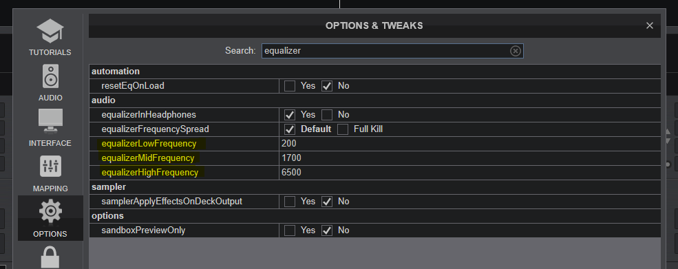

You can tweak your own range for the 3-band EQ
Little more tricky to show what frequency its at during use, the action (for example eq_low_freq) returns a value to the knob position (0 to 1)
Can also see this older post, might be of interest https://www.virtualdj.com/forums/226926/General_Discussion/VDJ_Equalizer_Settings.html

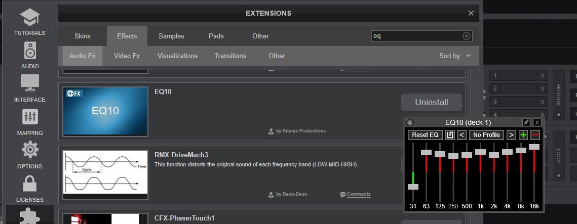

There is also a 10 band EQ plugin, that you might prefer to map
Will be quite easy
