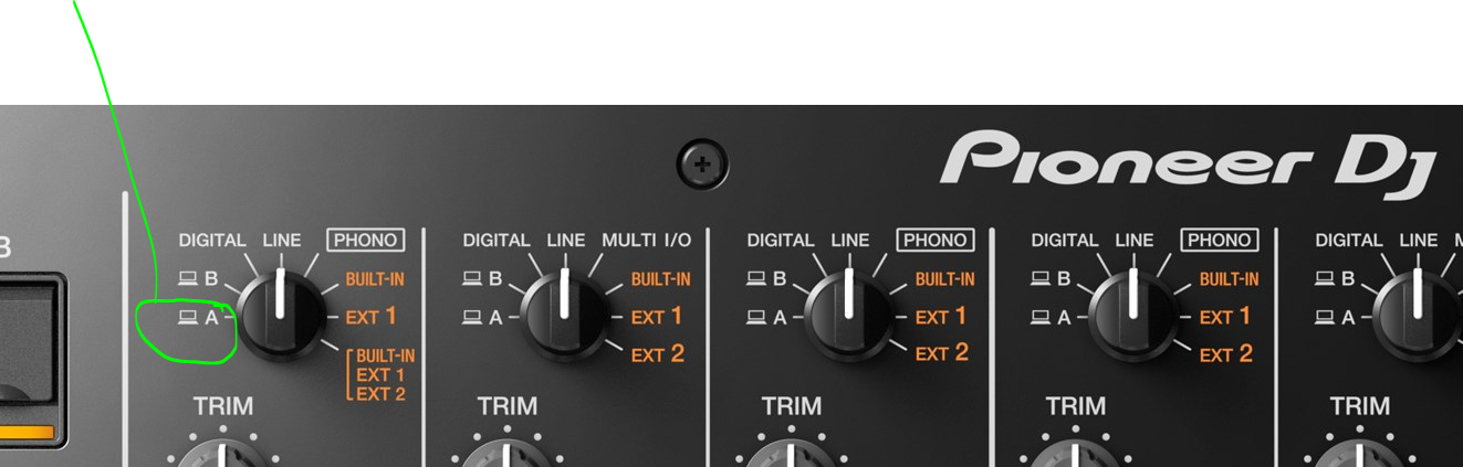

But try click the DJM-V10 button in the sound settings in VirtualDJ to make sure you have the default sound routing.
And at top of the channels try set channel selector is set to USB A

That means the channel VDJ is set to output sound to at the mixer is not set to computer input (and hence VirtualDJ is "muted" from sending sound)
Hence the USB A above, try set the channels to that.
Usually the case that you need to set to usb at the channel switch to "hear" the sound from the software at such a mixer

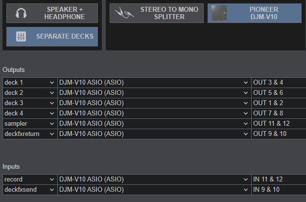

Depending on the USB port of the DJM-V10 you used to connect with your computer, you need to select USB A or USB B on each Mixer Channel or else you ll get MUTE in the respective VirtualDJ Decks.

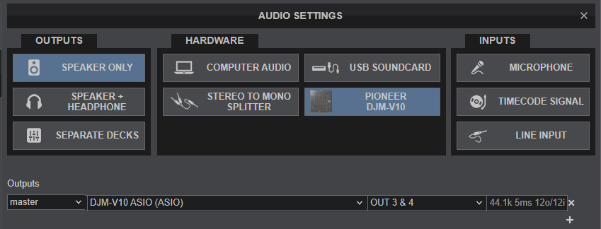

As for the Audio Setup,. you cant really use "Master" as Output Type. Clicking on the PIONEER DJM-V10 button at the top, VDJ will auto-create the following Audio setup and all you need to do is to have speakers connected to one of the Master Outputs at the rear.
PS. The 4 first Mixer channels starting from left will output VirtualDJ Decks 1 to 4 with Mixer Order 3-1-2-4 (can be changed). Mixer Channel 5 is reserved for Post-fader effects output and Mixer Channel 6 will by default output VirtualDJ Sampler.

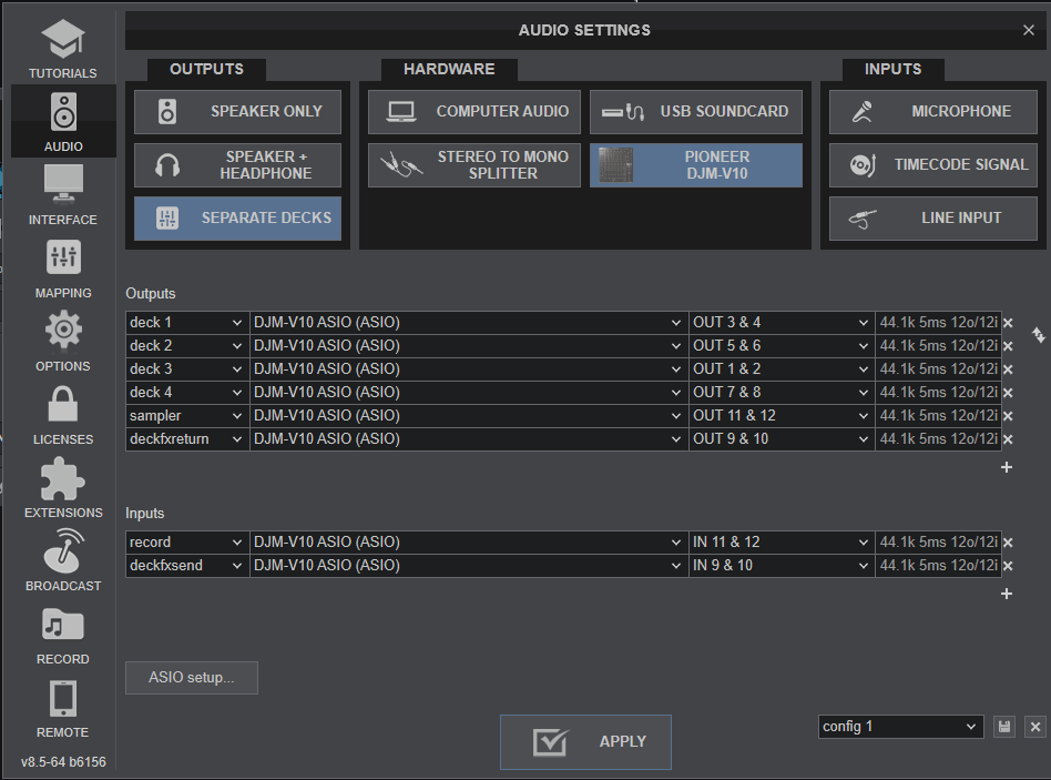

Just to understand...
You have the DJM-V10 connected to USB A or USB B port with your computer.
Pioneer ASIO is installed.
Audio Setup as the pic posted above
Speakers are connected to the Master Output of the DJM-V10
All DJM-V10 Mixer Channels Source selectors are set to A or B (depending on the USB port you use to connect)
You are using the DJM-V10 to mix in VirtualDJ and not the Internal VDJ mixer (skin)
Please confirm the above
BTW, you said that before the update you had the Pioneer ASIO (probably Chans 1,2) set as Master in VDJ Audio setup. This doesnt make much sense unless you were only using one Channel of DJM-V10 to output the Master of VirtualDJ and you were using mouse+keyboard and/or some additional controller to mix. Can you explain how you were using VirtualDJ with the V10 before the update ?

Simply add one entry in the VirtualDJ sound settings:
MASTER - Pioneer DJM-V10 Asio - Channel 3&4
That should work., but i dont have the mixer in front of me to confirm,. but at least give that try.
Seems like that might be the correct asio channel to use.
And make sure channel 1 is set to USB A or USB B, corresponding to how you connected the mixer via usb to your computer
DJ Dad (babis) have the mixer so he will be able to confirm how to set up the mixer in the rather odd way you are looking for ;-)
