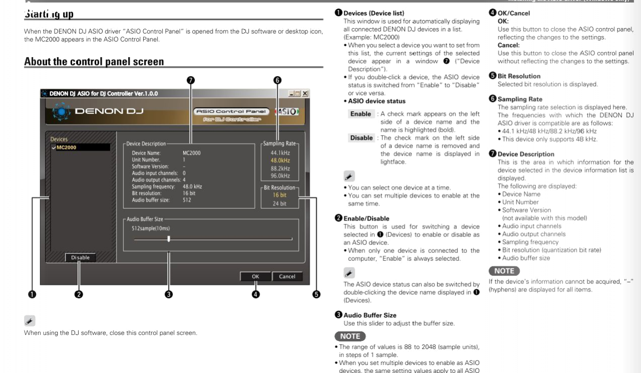

Is this where you're adjusting the latency? What's it set to now?

@ groovindj Yes im adjusting the latency in the Denon control panel, currently got it set at 1ms
https://i.ibb.co/41YSn6G/cp.jpg
