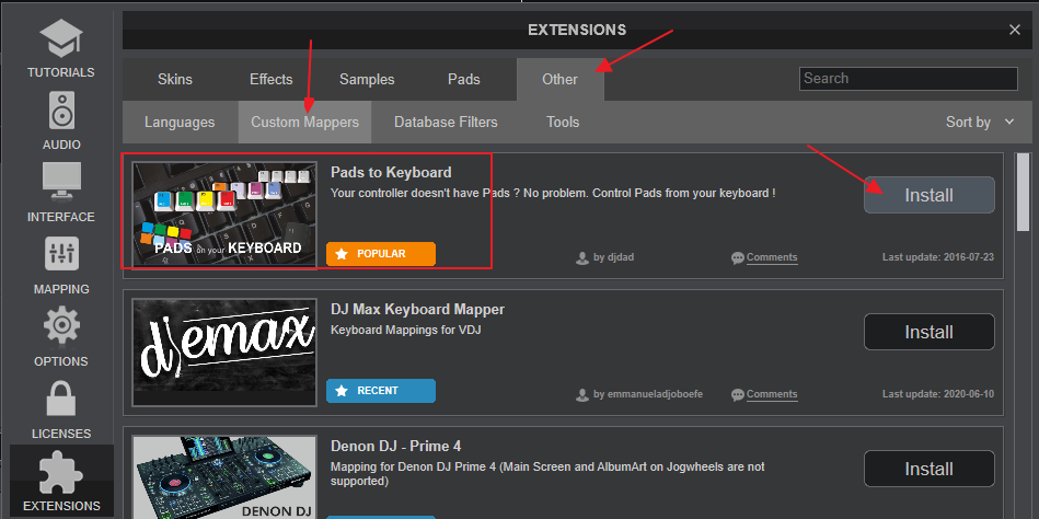

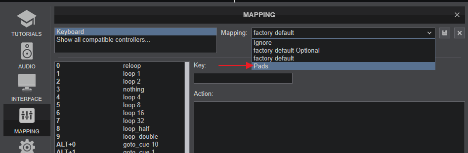

If you need to control Stems with buttons/pads, and have kills/isolate functionality, you could use this keyboard mapping https://www.virtualdj.com/plugins/index.html?addonid=80421 , select the Stems Pads page from the skin, and then use keyboard keys F1 to F8 to control Pads.

Thank you. I am at the extension page. Which one should I install. Please bear with me, I am still learning.

Posted Sun 09 Aug 20 @ 6:12 pm
Thank you. I was able to map all the keys but it is still not working.

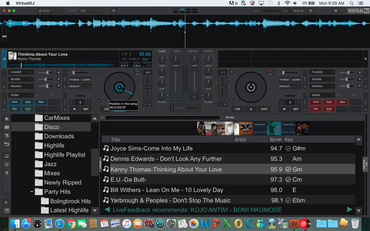

Ok, can you post here a screenshot of VirtualDJ skin with a track loaded and the Stems page selected on Pads ?

Posted Mon 10 Aug 20 @ 11:30 am
From the top LAYOUT menu, choose Waveform Display->Shapes, so that you can see the Stems analyzed on the song progress bar.
Do you get something like this ? ..
If you do, pressing on any Pad on the Stems Pads page, should kill a Stem
