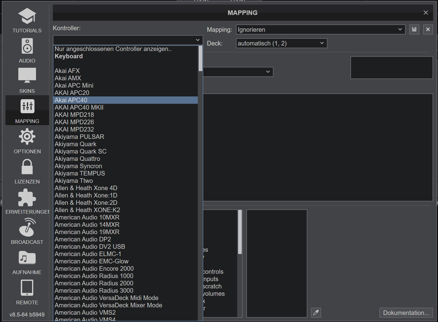

The name "MYCONTROLLER" does not appear in the list, but an empty line appears in the list now. This means the syntax is wrong.

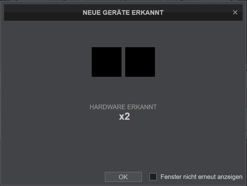

As soon as i start Virtual DJ, is shows me a window that a new hardware ist found. Without name:
After that i still see the empty line in my controllers list.
So im 100% sure the syntax of the file is not valid. Maybe it is outdated...

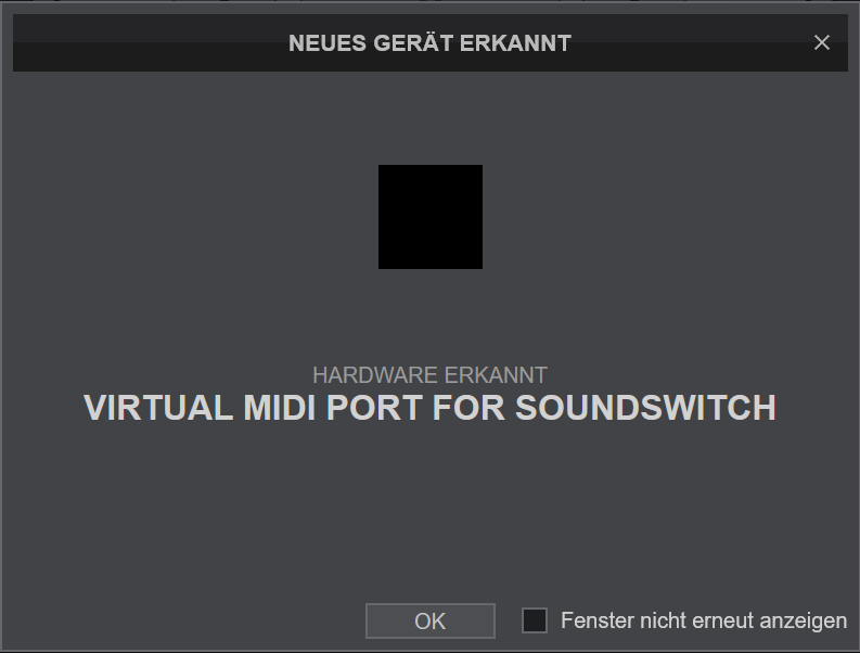

Thank you.
ok, now i catched it. Please excure, english ist not my main language. Ive added the description now:
<?xml version="1.0" encoding="UTF-8"?>
<device description="Virtual MIDI Port for SoundSwith" name="Virtual DJ MIDI Port" sysexid="F07E7F0601F7" type="MIDI" >

And now the correct name appears at start and at the list:

And the device will be found correctly:
But, if i select it, the button definition for play and cue is missing:
Ive expected these definitions, because its written into the XML file.
