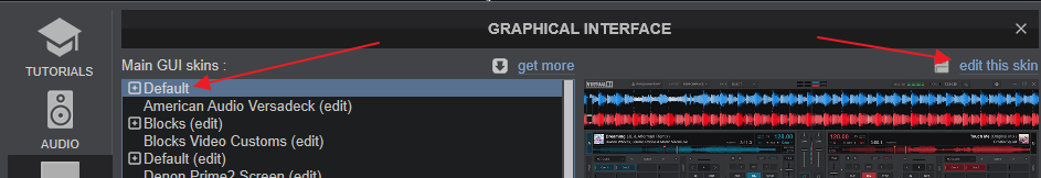

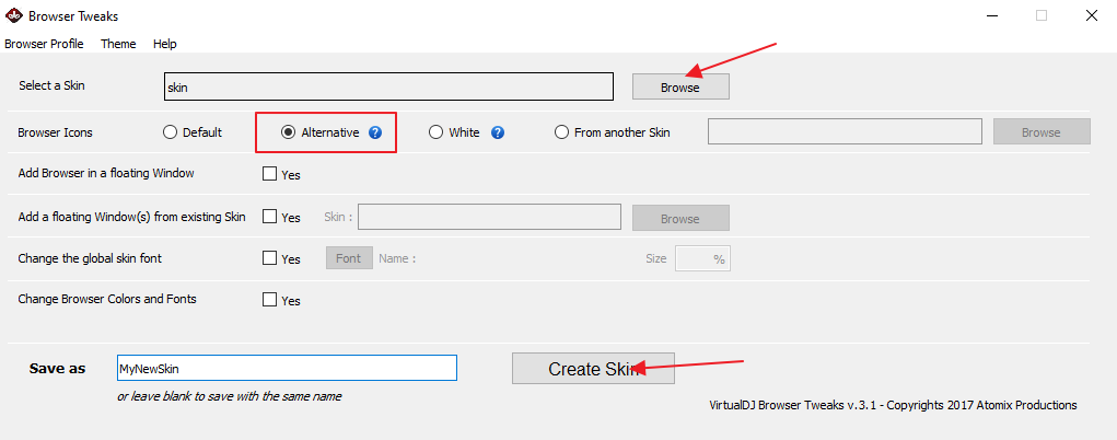

          You can add Custom Icons to any skin, even the Default one, using Browser Tweaks.
Especially for the Default skin, you first have to extract it, so here are the steps..
1. Select the Default skin and then click on "Edit this skin"
2. Zip the files from the created folder (/Documents/Skins/Default) to a zip file , but dont name it as Default- e.g. MyCustomSkin.zip
3. Put the zip in Documents/VirtualDJ/Skins folder
4. Download and open Browser Tweaks from https://www.virtualdj.com/plugins/index.html?addonid=80491 (Windows only - sorry)
5. In Browser Tweaks, select the skin you want to edit, choose the "Alternative" icons (it's the same as in Blocks skin) , uncheck "Change Browser Colors and Fonts" and then extract.
6. In VirtualDJ, Settings->Interface tab, select the skin you extracted

Thanks DJDad, was able to grab the icons from Fruit's skin! I'm guessing every time there is an update to the default skin ill need to changes the icons from Fruits?

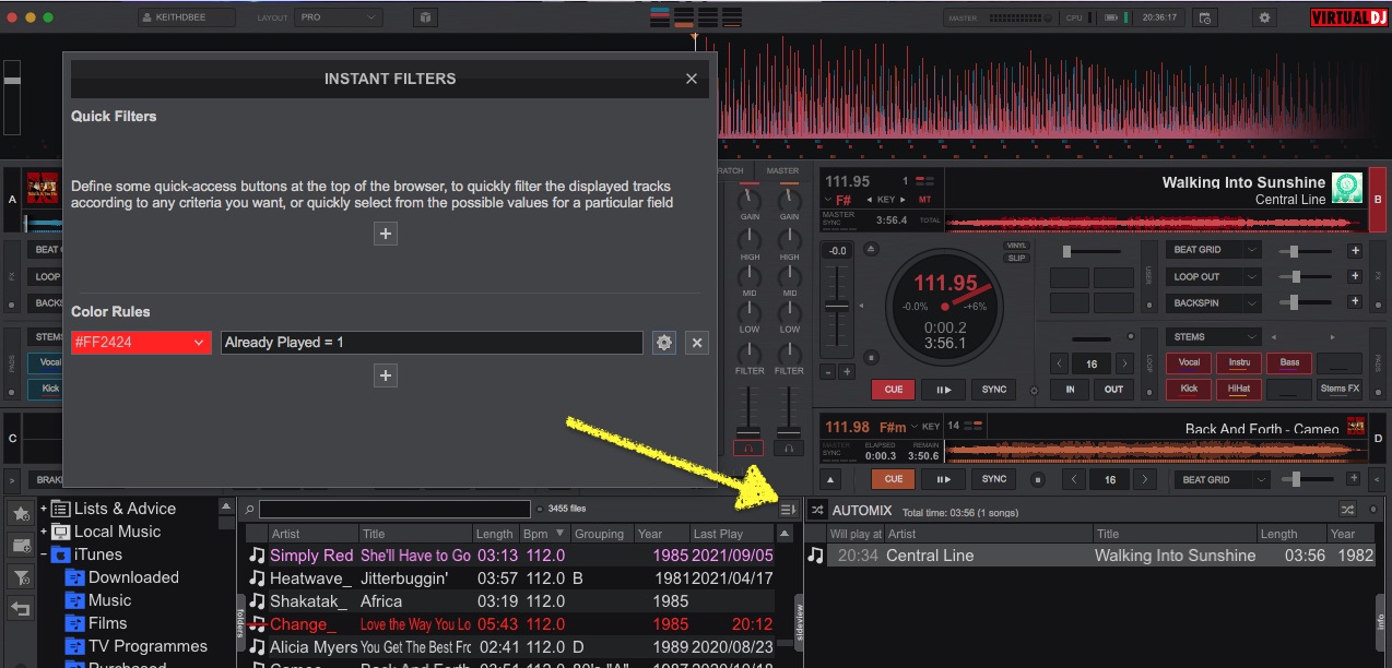

@groovindj, @The Hofff I did this at a gig on Friday & it worked great - when a track played, the track text in the browser changed to red. At the end of the gig I selected all songs in the browser, hit a button & the text colour reverted to black for all tracks, played or otherwise. Very clear what songs had been played & dead easy to do. See my earlier post in this thread for a quick & dirty way to do it.

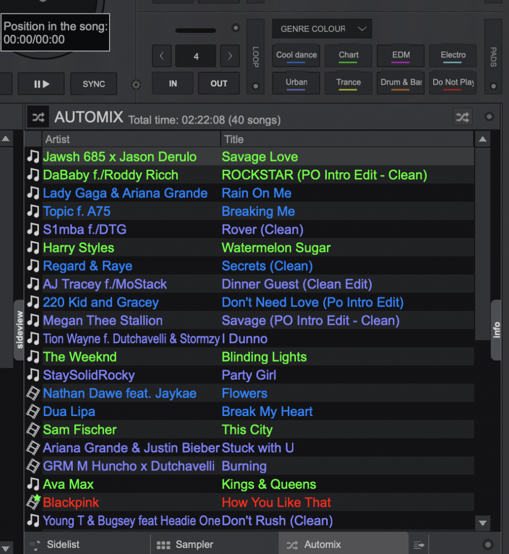

          I like the idea of better visualisation of tracks that have been played in the default skin. Colouring the text within the browser would be OK, if, the colour could be selected because I and many others already use the colour option for our tracks.
I have my own system demonstrated in the screenshot below. I have set up a pad page with the main colours I use and the Automix list below is the current UK Top 40 Chart. I started doing this a few years ago when I was being bombarded with loads of new tunes from Promo Only. At a glance, I can see what genre a tune is even though not knowing it. Luckily, Promo Only has the genre in the Tags for m4a files making it very easy to select without the having to audition them all. Red is 'Do Not Play' meaning it is explicit and not to be used at weddings. ;-) I also use red temporarily if I'm supporting a band and get their playlist off them so as not to play what they are going to play.
So, I would need to be able to select a unique colour that does not clash with the colours I'm already using.

          How to Change Your Played Tracks to a Colour (Red)
