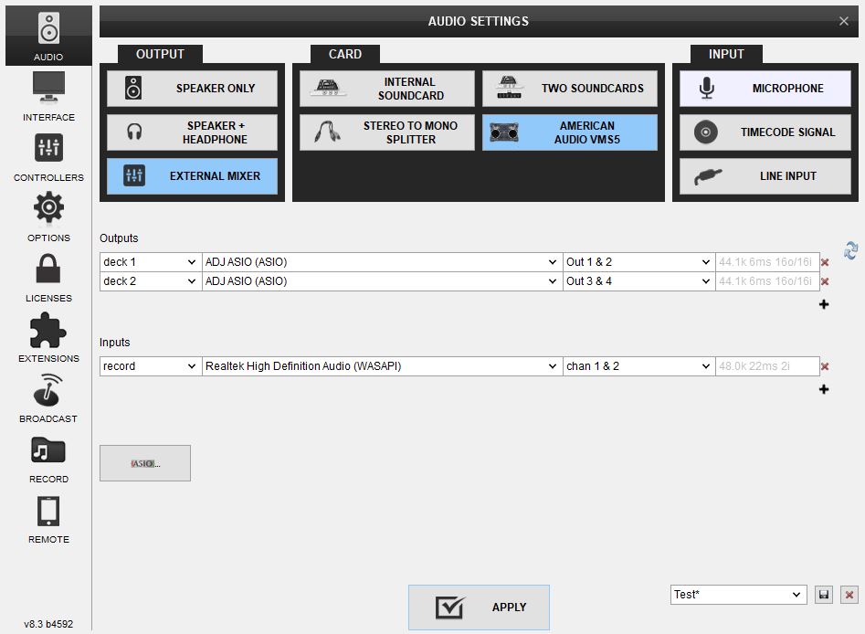

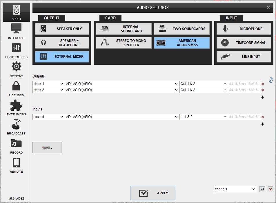

Hi thanks for the reply, when i go into the settings, I don't have an option on the drop down menu for record on output section, options I have are:
Master
Headphones
Deck 1-4
etc...
Booth
Preview
Sampler
but if I click input I can then add record, would this be the correct set up in the image shown?

ok so the REC setting didn't work, do you have any suggestions on external sound cards that work well with VMS5 that will do the job, maybe something not too expensive to get me up and running, Thanks.

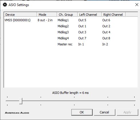

Are you sure your VMS5 is on 8-out mode ?
Click on the ASIO button in VDJ Audio Setup and post a screenshot here
Before buying any additional sound card, try the one your computer has.
- Connect the BOOTH OUT (rear panel of the VMS5) with the Line/Mic Input of your computer, using some Stereo RCA to Stereo Mini-Jack cable
- In VDJ Audio setup, instead of having the "record" Input to use the VMS5 sound card, change it so that it uses your Computer's built in.
- Record a small mix and see if the quality is good enough with what you have

It is set to 8 out, so connected booth to line in and still nothing it would seem

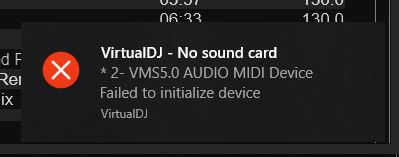

Also I have noticed when trying different settings at point it comes up with a message as shown when selecting 2- VMS5.0 AUDIO DEVICE 9WASAPI) which I have uninstalled both ASIO drivers and VDJ and installed them ASIO then VDJ as other post had mentioned to do
