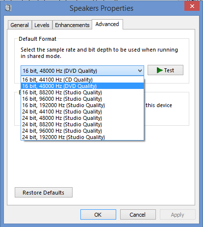

You can change that in Denon settings..
Typically the driver panel will look something like this :

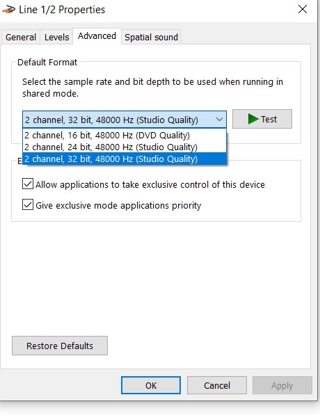

Ok I tried the wasapi route but it won't let me change from 48khz.

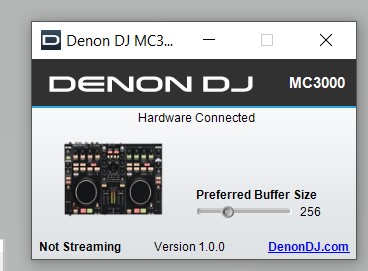

Then I tried downloading the legacy drivers and this was all that the control panel had.
I do remember that control panel on the image you attached so maybe they have just packaged the panel down to that basic one as its so old?

Is the screenshot above for Denon settings in Windows driver?
Says "Line in1/2 " ... is that some pc sound card perhaps?

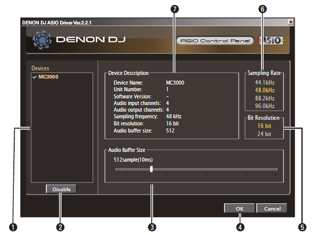

For the asio, maybe the Denon have a simpler interface for the MC3000. Or you downloaded an older or simpler driver (yours says version 1.1) (but pretty sure I've seen the more advanced driver panelt around though, see image below as well, note it says version 2.xx)
