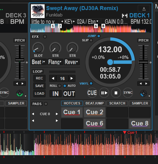

Could you please tell me the location of the font sizes on the text document for the cue points? Or at least the fontsize and i can search by that. I am wanting to enlarge the font of the cue numbers on the wave forms. Thanks for your time.
Posted Fri 11 Nov 22 @ 11:38 pm
There are many Positions to Change. You must Search your favorite used Wave:
for every Wave Size one
define class="scratchwavemainextrasmall"
define class="scratchwavemainextrasmallhalf"
define class="scratchwavemainsmall"
define class="scratchwavemainsmallhalf"
define class="scratchwavemainmiddle"
define class="scratchwavemainmiddlehalf"
define class="scratchwavemainlarge"
define class="scratchwavemainlargehalf"
define class="scratchwavemainextralarge"
define class="scratchwavemainextralargehalf"
define class="scratchwavemixervertical"
define class="scratchwavemixerhorizontal"
you can find this Tags 3 Times
1. Font Size Normal -> textsize-define-normal---
2. Font Size Bigger -> textsize-define-large---
3. Font Size extra Big -> textsize-define-extra-large---
change the Fontsize
<text dx="9" dy="-2" fontsize="11"/>
change the Fontsize
<define class="scratchwavemainextrasmall" orientation="horizontal" placeholders="*width,overlayx,background,backgroundshaded,gridpos" colorVocal="wavevocal" colorInstru="waveinstru" colorBeat="wavebeat" colorNoVocal="wavenovocal" colorNoInstru="wavenoinstru" colorNoBeat="wavenobeat">
<size width="[WIDTH]" height="20"/>
<grid mirrored="yes" pos="[GRIDPOS]"color="wavegridcolor" maincolor="wavegridcolormain" backgroundcolor="waveshadow" background="[BACKGROUND]" backgroundshaded="[BACKGROUNDSHADED]" height="3" size="1" mainsize="3" shapemirrored="both"/>
<gridlines width="1" color="wavegridcolor" transparency="0.5"/>
<cue y="-4" height="28">
<mask width="13" height="28" x="179" y="407"/>
</cue>
<overlay>
<size width="1" height="30"/>
<pos x="+[WIDTH]/2" y="-5"/>
<background shape="square" color="waveoverlaycolor"/>
</overlay>
</define>

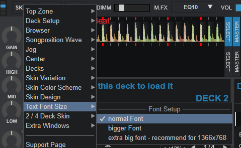

I changed these font sizes ( I changed all font sizes from 11) however the font size of the cues on the waveforms are still very small.
Posted Sat 12 Nov 22 @ 6:13 pm
i change in this Tag the fontsize from 11 to 16 and the Font is bigger.
which "Text Font Size" do you use in the Skin?
<define class="scratchwavemainsmall" orientation="horizontal" placeholders="*width,overlayx,background,backgroundshaded,gridpos" colorVocal="wavevocal" colorInstru="waveinstru" colorBeat="wavebeat" colorNoVocal="wavenovocal" colorNoInstru="wavenoinstru" colorNoBeat="wavenobeat">
Posted Sat 12 Nov 22 @ 6:52 pm
<size width="[WIDTH]" height="40"/>
<grid mirrored="yes" pos="[GRIDPOS]"color="wavegridcolor" maincolor="wavegridcolormain" backgroundcolor="waveshadow" background="[BACKGROUND]" backgroundshaded="[BACKGROUNDSHADED]" height="6" size="1" mainsize="3" shapemirrored="both"/>
<cue y="-9" height="58">
<mask width="13" height="58" x="179" y="407"/>
</cue>
<overlay>
<size width="1" height="60"/>
<pos x="+[WIDTH]/2" y="-10"/>
</overlay>
</define>
Thanks!..Found it!...this helped.

When you found your personal favorite Size. Tell me this please. I can integrate this native for you.
