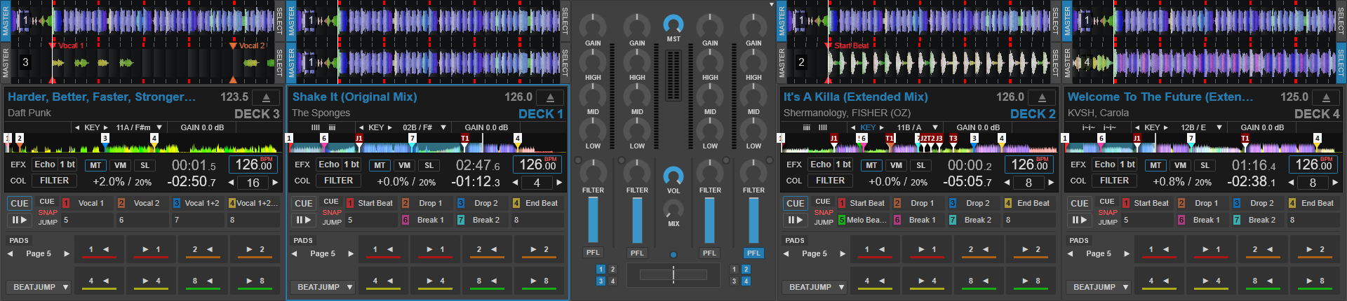

Coming soon 4 DECK vertical.
Congrats. 4 Decks Vertical is the right way to GO. Can't wait to give it a SPIN.!!!

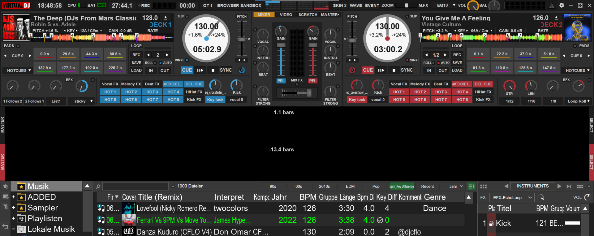

Hi DennYo,
unfortunately by installing the latest update I cannot see the Scratchwave anymore (see screenshot). I can only see the Classicwave type. I tried different skins (also the original one) and there it works. Is there anything I can do to solve this problem?
Or is it possible to go back to an older version of your skin without losing my custom buttons?
INFO: I am using the skin "Controller 2020 by DennYo", Version 3.2.9 from 2022/08/17 on Virtual DJ Pro v8.5-64 b7123 (Windows 10 64bit).
Thanks in advance!

Double check that the selection of Waves is set to the correct ON or OFF Position.
Posted Mon 05 Sep 22 @ 5:42 pm

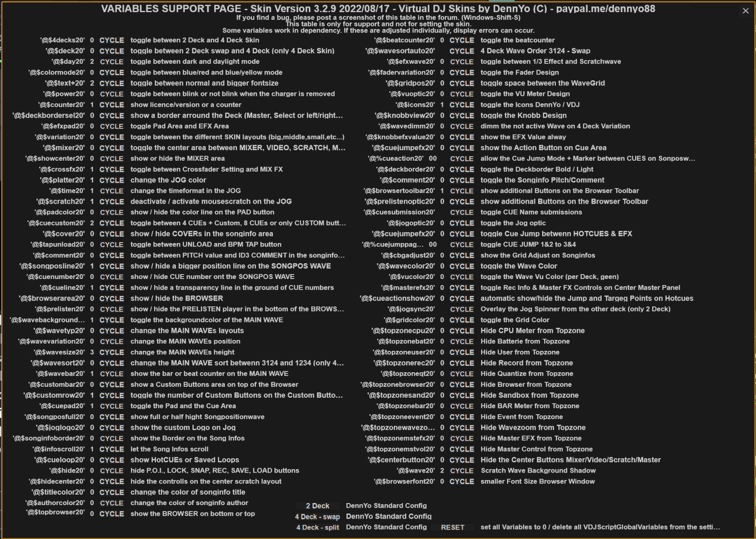

Please post a Screenshot from the Variable Support Page.
I think the Problem is the Variable wave20 (the last) in the past it goes to "4". Now, only 0, 1 & 2. Cycle this Variable to 0 or to this what you want..
'@$wave20' 0 -> Scratchwave Backgroundshadow 1
'@$wave20' 1 -> Scratchwave Backgroundshadow 2
'@$wave20' 2 -> Scratchwave Backgroundshadow off
Posted Mon 05 Sep 22 @ 6:57 pm

I tried what both of you said, but still no Scratchwave there. Here is the screenshot you asked for:
Posted Mon 05 Sep 22 @ 7:48 pm
I found the Bug. It comes from the extra large Font size.
The good news: The Skin Update 3.3.0 is online and the bug is fixed.
I spended so much time for this update. I forgot that this Bug was there.
Posted Mon 05 Sep 22 @ 10:23 pm

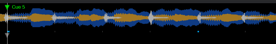

Thank you so much!!!
Just 2 Things:
1) I still have a (minor) problem, though: when playing tracks with cue points under the cue point marker a line in the same color as the cue point marker appears and follows the track (see screen video).
2) Is it possible to get different colors for the different frequency and stem types like in the proejct X skin where you can mimick Denon wave shape style or also a Pioneer wave shape style (see screenshot), e.g. blue for beat stem (or lows), yellow for instrument stem (or mids), white for vocal stem (or highs)....
Just 2 Things:
Posted Wed 07 Sep 22 @ 5:07 pm
@Zabie
first:
you have not the screen resolution 1920x1080. I can reproduce the Bug when i shrink the Skin. I will look for an fix.
In Fullscreen there is no problem.
second:
this is since Version 3.2.6 in my Skin:
first:
second:

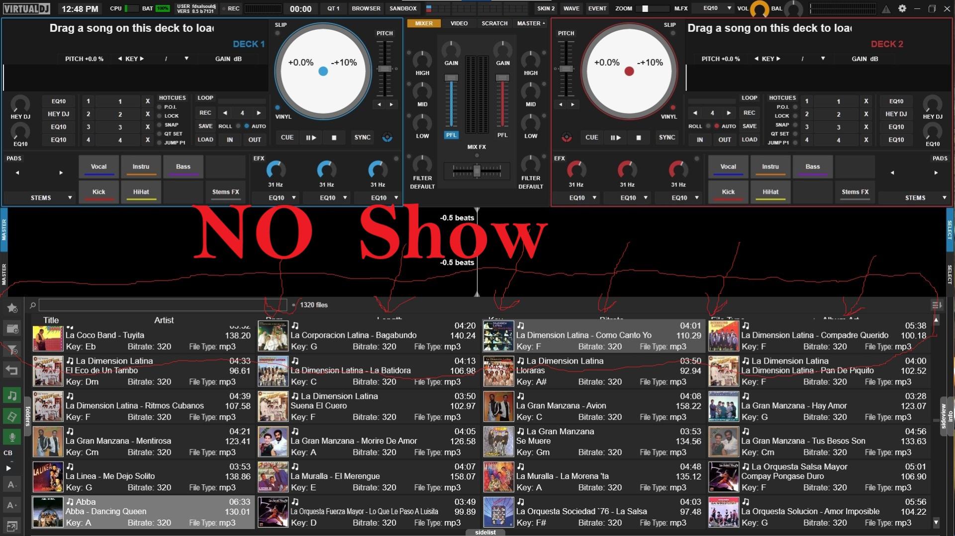

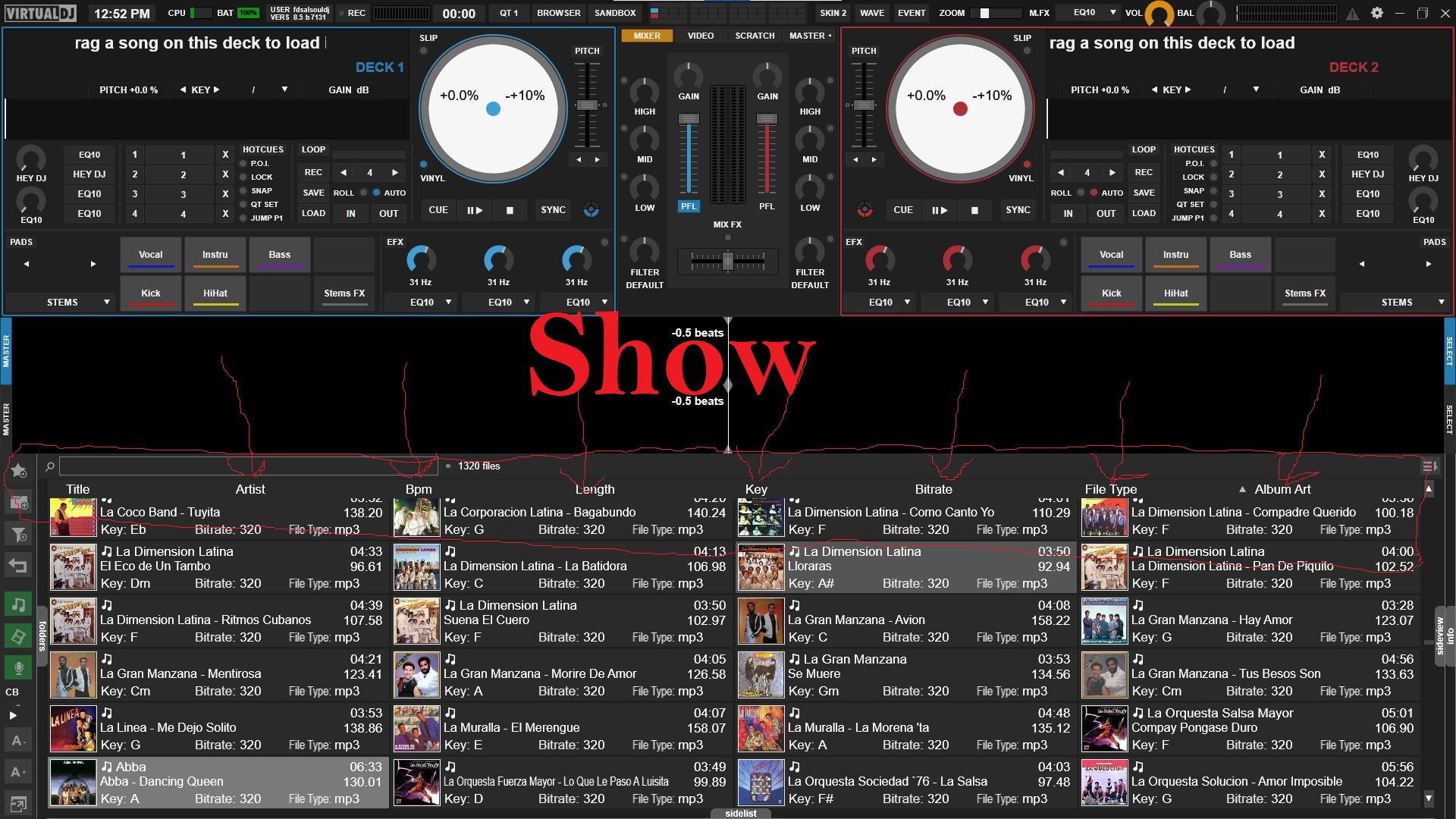

Hi DannYO. for some reason when the upper road is highlighted, the files info is overtaken. could it be a BUG? Thanks for the Upgrades. Your hard work is Appreciated.!!!
Posted Mon 12 Sep 22 @ 5:09 pm
This is a Bug. But not from my Skin. Its a Bug from the Browser. I can reproduce this also in the default Skin.
Posted Mon 12 Sep 22 @ 6:53 pm

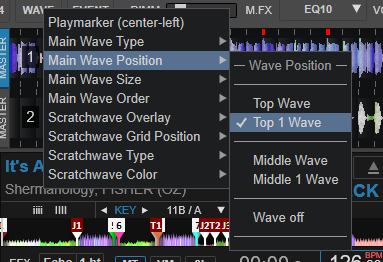

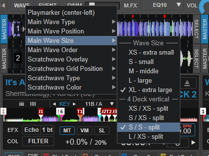

Thanks for a great skin. I love the 4 deck totally the best!. I was wondering if at some point can you add the option to click the clock to get the stopwatch?
And possibly the option for the main wave to be half wave like we can in the songposwave?
Thanks again!
Posted Fri 14 Oct 22 @ 10:41 am

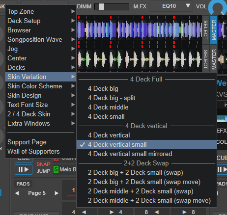

Version History 3.3.3 - 2022/10/17
Bugfix - Position correctures
add - new Variation 4 Deck vertical small + mirrored ("Skin Button"/Skin Variation/4 Deck vertical small)
add - Wave Variation "split Wave" for 4 Deck vertical and 4 Deck vertical small with Botton/Top Wave 1. ("Wave Button"/Wave Size/4 Deck vertical)
add - Sideview Window
add - Sidelist Window
add - half Main Scratchwave ("Wave Button"/Wave Size/Wave full halve)
change - optimize Code
New Variation: 4 Deck vertical small
