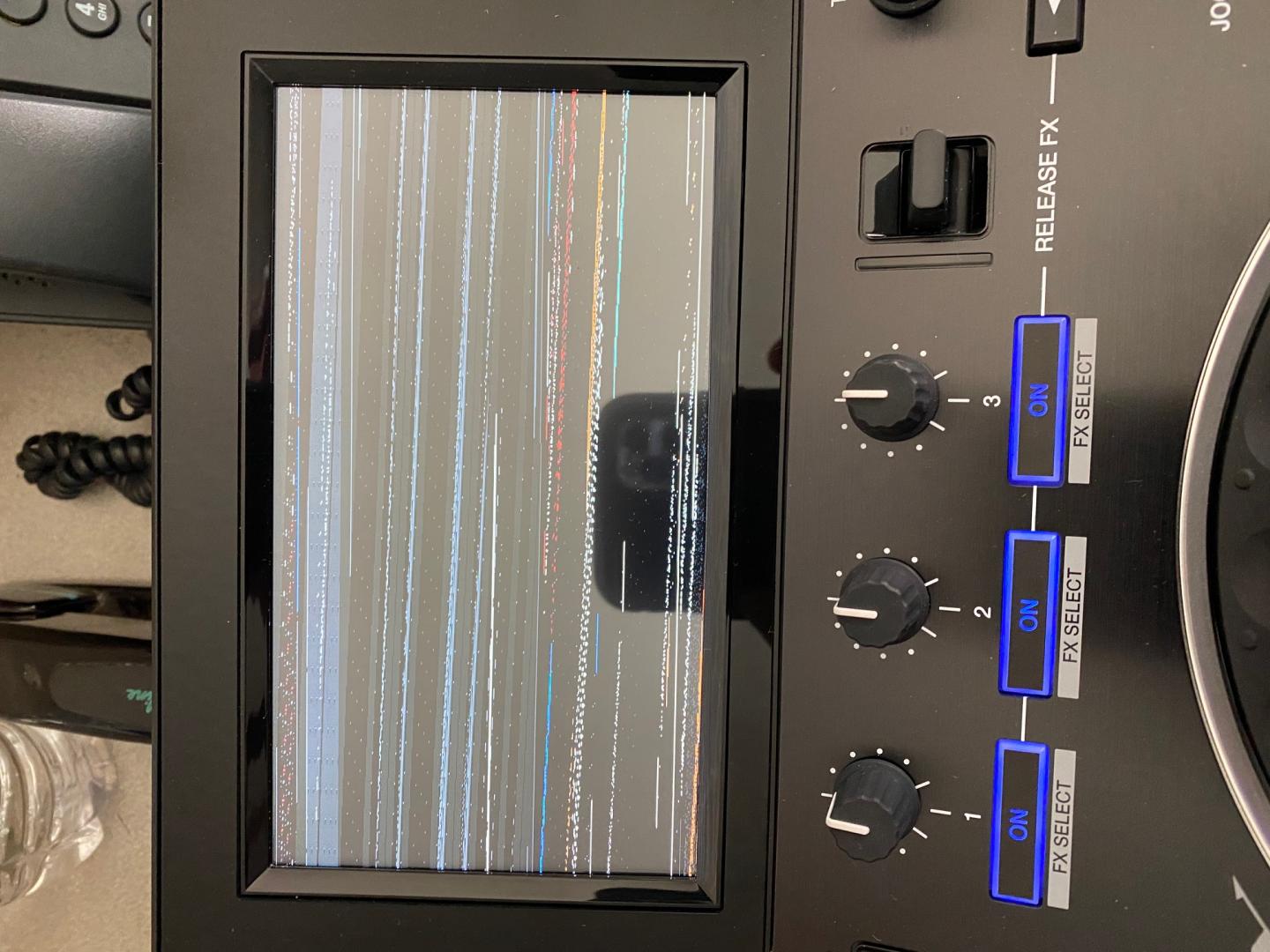

Note: I am running VDJ 2018 versus VDJ 2020 because in VDJ 2020 and all 3 screens on the RZX go all crazy with unreadable lines, etc.

I found the fuzzy screen issue on all 3 screen of the DDJ-RZX only happens if using VDJ 2018 or 2020 64-bit version. 32-bit version of VDJ does not cause issues with the fuzzy screens.

Hey VDJ Support - when will you ever work on these unresolved issues (no master output and fuzzy screens) with the DDJ-RZX?

The screen issue, is not something we can reproduce. Screens work fine here in almost 10 different systems... (3 MAC's and 6 or 7 Windows Desktops and Laptops)

PS: DDJ-RZX screens work via a network connection. (LAN over USB).
ANYTHING that could intervene with your network connection(s) could be a possible cause for your screen issue...
Antivirus, Firewall, Network Traffic Monitoring...
We don't know your system... But at least as a test you should turn everything off and try just with the absolutely necessary tasks running in the background.
