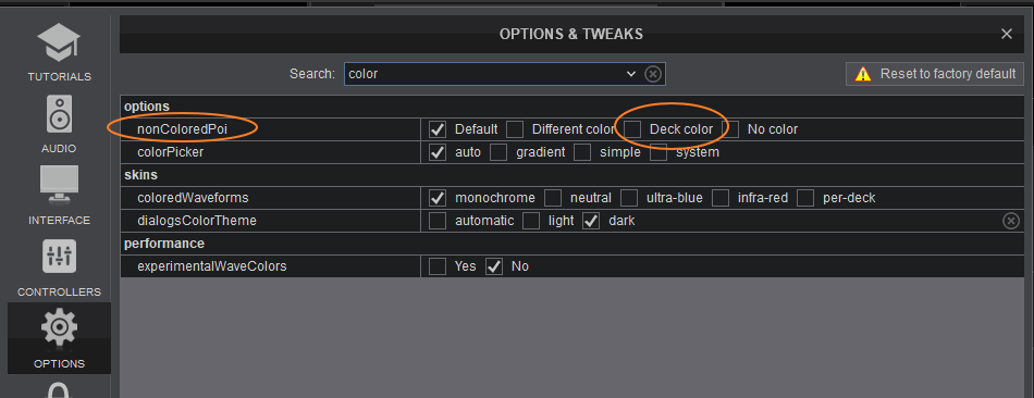

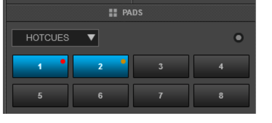

I upgraded to version 8.4 and it messed everything up. The new version added annoying colored "dots" to the queue button in my interface (after i had to switch back to the 'Old' interface in the Settings). those annoying dots now seem to govern the queue light colors on my Traktor S4 board. The colors of the queues on my board USE to light up corresponding to which channel was active, which is what i WANT and was one of the reasons i was using VDJ.
How do i get rid of the colored "dots" on my queues? This is a pretty big change and i now can't work on my projects until this is resolved. Please help me.
The dots can be seen next to the 1 and 2 cue buttons on the attached image. I want them gone so that the cue colors on my board match my track color on the vdj interface
