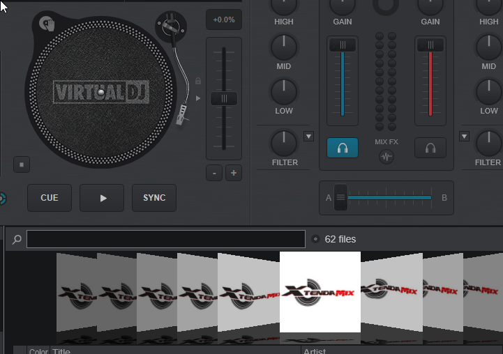

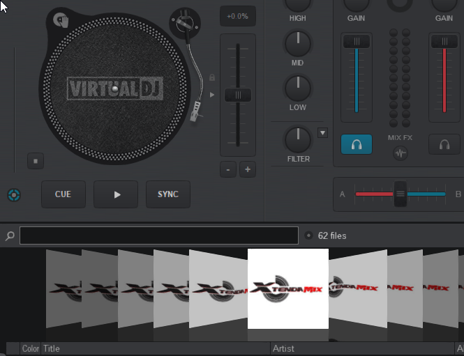

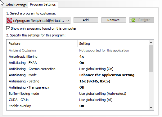

Yes.. I have just downloaded the 64bit version. I have replicated the video settings for the NVidia panel (both 32bit and 64bit versions of Virtual DJ) -- I have added some attachments so you can see the issue... The settings in VirtualDJ for Video are for both versions to use the NVidia card.
32BIT SMOOTH GRAPHICS ON THE ALBUM COVERS
64BIT JAGGED GRAPHICS ALBUM COVERS
NVIDIA SETTINGS FOR BOTH 32BIT and 64BIT

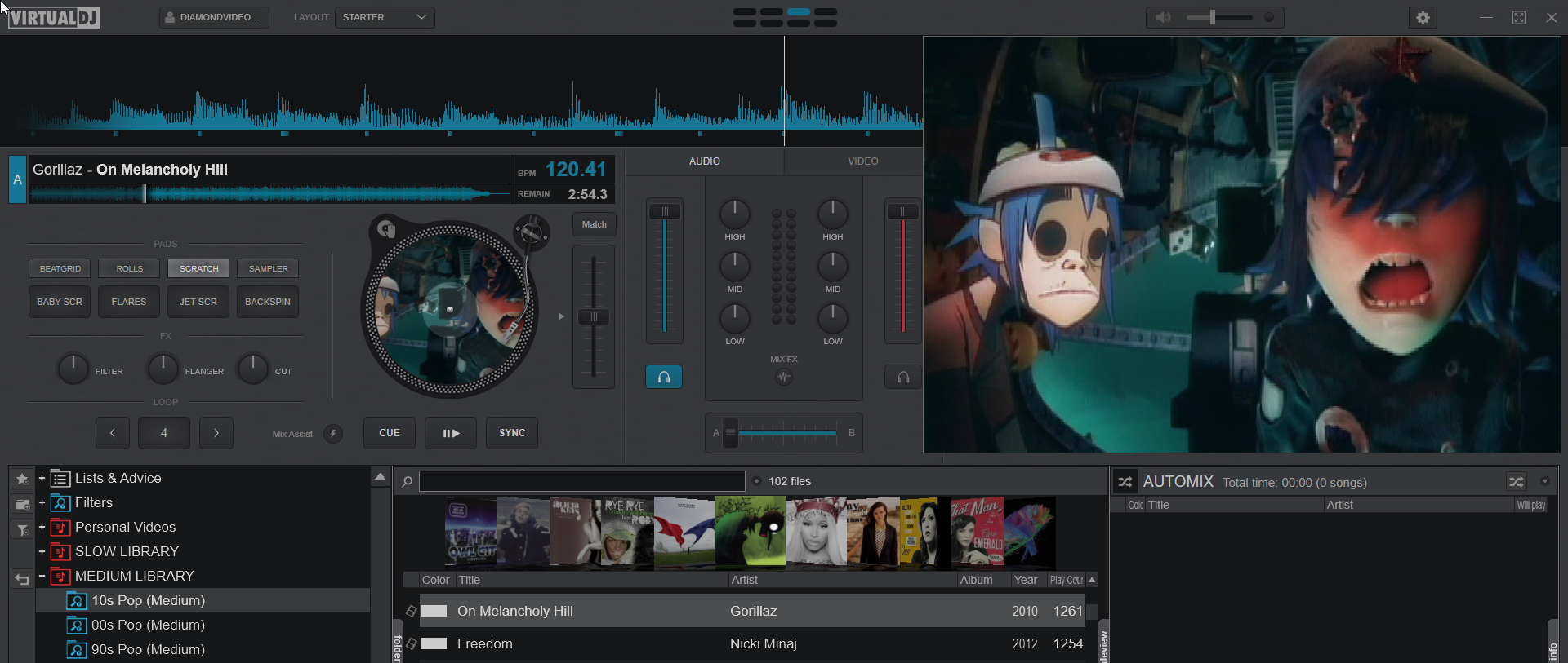

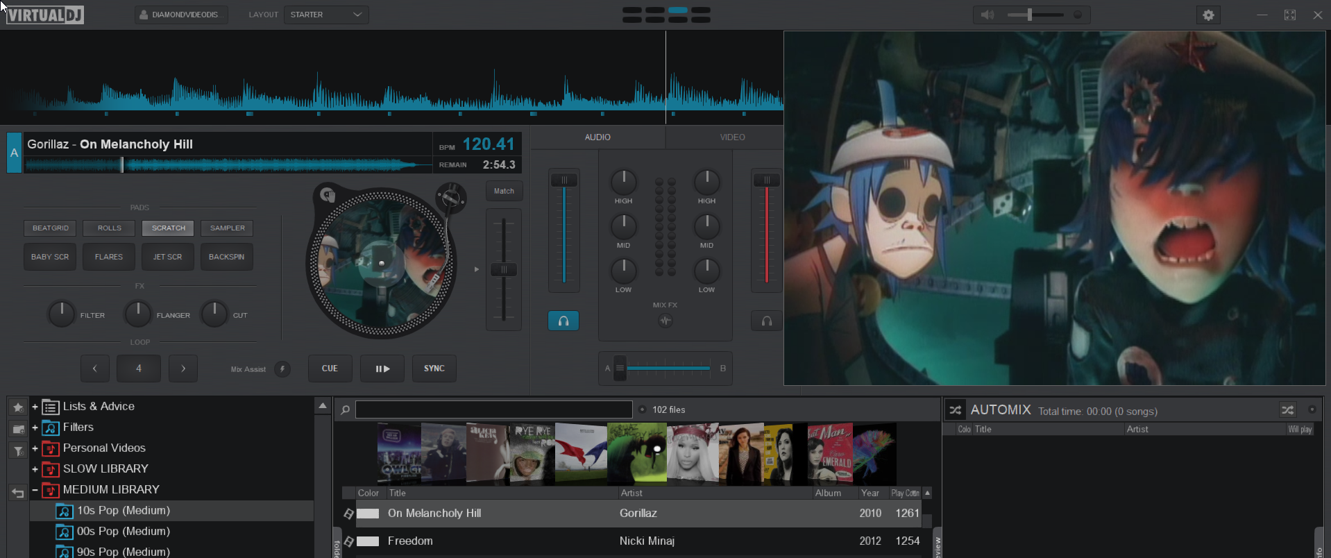

Screen grabs from a Standard Definition Music Video (same file in both 32bit and 64bit versions) - look at the diagonals (chin area of faces etc...), the 64bit version appears to be worse... any ideas why? Could it be a sharpening option???
64BIT running a standard definition music video
32BIT running the same standard definition music video

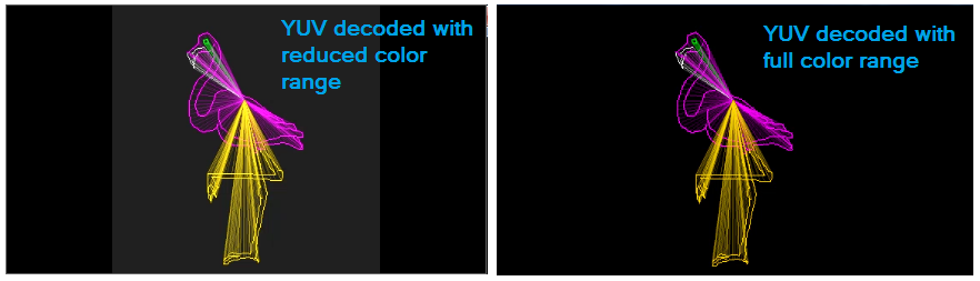

Not necessarily related to smoothness issue, but you should notice in the above images (video display area) that in the 32 bit version the colors are washed out while in the 64 bit version the colors are more vibrant. This appears to be due to 32 bit version using reduced color range for YUV decoding which is not good either. 64 bit version appears to be using the full color range for YUV decoding.
Here's an image that shows the difference more clearly. In the reduced color range you can see gray when it should be black.
