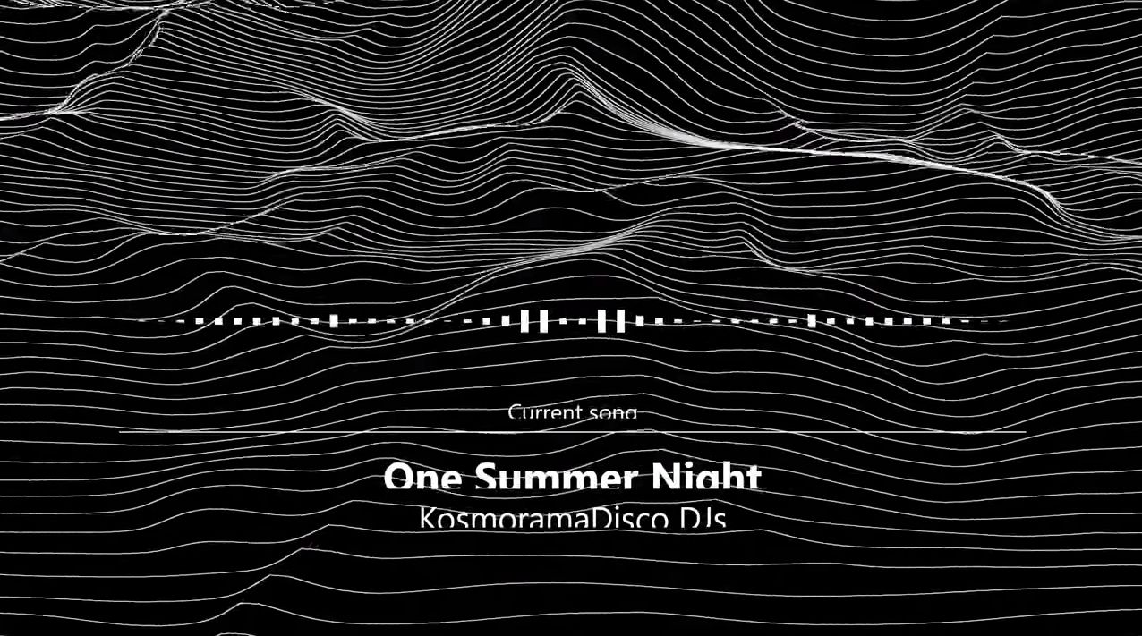

I'm having a minor issue with text in video being cropped a little:
Thoughts?

You are not the only one, I have exactly the same problem.
Posted Mon 01 Jul 19 @ 1:38 pm
It's the update Atomix did to add browser padding. If you go back to a build before browser padding, you should find it's OK again.
It's affecting normal skins too.
Posted Mon 01 Jul 19 @ 4:22 pm
I changed the setting "experimentalScinEngine" from "auto" to "no" and the problem was gone. Then this setting to "yes" and now everithing fine. Back to "auto" and everything ok now. (v8.3 b5046)
Posted Tue 02 Jul 19 @ 2:40 am
No issue here with latest Build 5046. Anyone still has an issue ?
Posted Wed 03 Jul 19 @ 2:38 pm
Yes, the trick as described works in the 32 bit, but not in the 64 bit version (v8.3-64 b5046). PC W10
Posted Thu 04 Jul 19 @ 4:56 am
Can't reproduce with VDJ 32bit Build 5046, with experimentalSkinEngine to Yes or No.
There is an issue with the 64bit Build though (we see that), and will be fixed in a future update.
Posted Thu 04 Jul 19 @ 9:18 am
I am also unable to reproduce, but I am so happy that it works so far. Thank you for your great work.
Posted Thu 04 Jul 19 @ 9:24 am
This problem appears to be fixed in the latest 64-bit beta.
Good luck.
Posted Fri 12 Jul 19 @ 4:02 pm
Everything ok now.
v8.3 b5095 and v8.3-64 b5095. W10
Thanks a lot.
