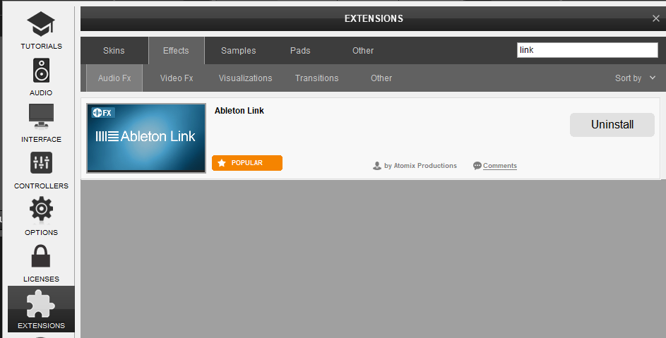

SteveMaddison wrote :
cant understand why if it's part of the build why it doesnt appear ???? (or how i can make it appear)
It's included but not visible before you install it
I just re-tested, and this screenshot in on Win10 with the latest 32-bit public version of VDJ8.3/2018, which is build 4918

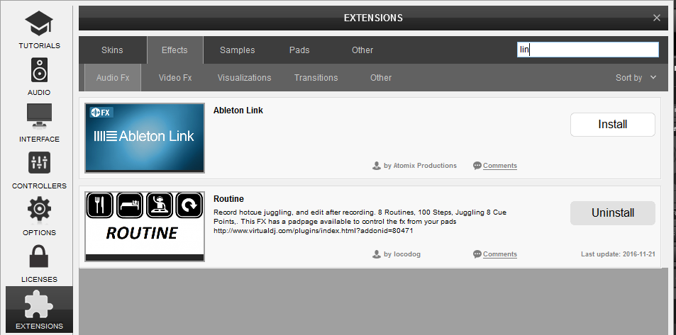

          im on build b4514
how do you press the install button if it isnt visible ??
my understanding is you can see it in the audio fx extensions, you then click the 'Install' button to install it
but it's not there, how do i install if its not visible / there ?
Posted Fri 10 May 19 @ 12:52 pm
          The current public build is 4919, so you need to update if you want to use Ableton link.

          Updated to latest version, yep that done the trick, thanks V.muchos
