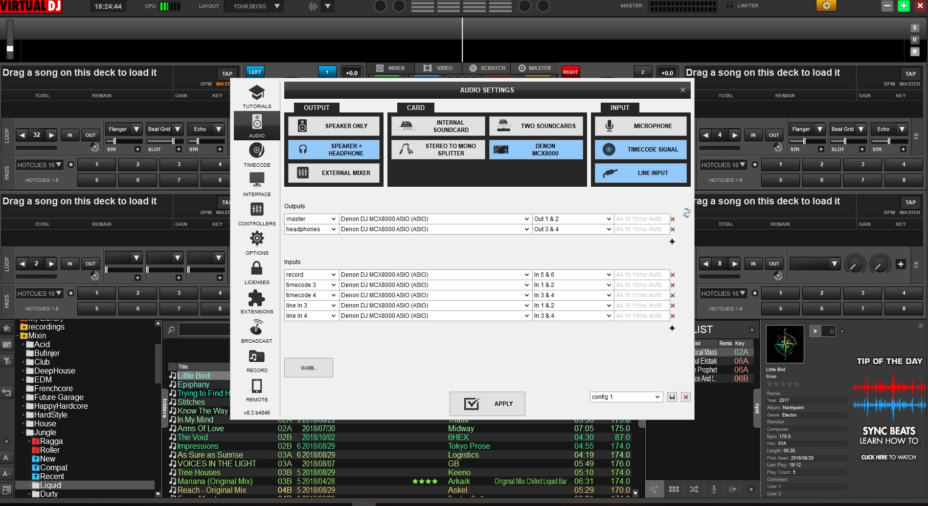

locoDogPRO InfinityModeratorMember since 2013
How does your audio config look?
Posted Sat 20 Apr 19 @ 5:17 pm
Same as before I just deleted my mappers and did a fresh reinstall as only my custom mapping was showing up and I wondered if maybe if had been changed for the new build but same problem on factory mapping and fresh install re tried all the mixerOrder settings restarting application each time but still same probs
Posted Sat 20 Apr 19 @ 5:28 pm

Open VDJ Settings, goto Controllers tab and check Deck Assignment for all 3 devices. Main unit should be assigned to 1 2,3 4 and Displays to 1 3 and 2,4
Posted Sat 20 Apr 19 @ 9:26 pm
Brilliant thanks DjDad I knew there was an option like this but forgot how to access it problem solved now as far as I can tell had to change to mixerorder setting and restart looks like everything is now all matched up like it should be nice one m8 :)
