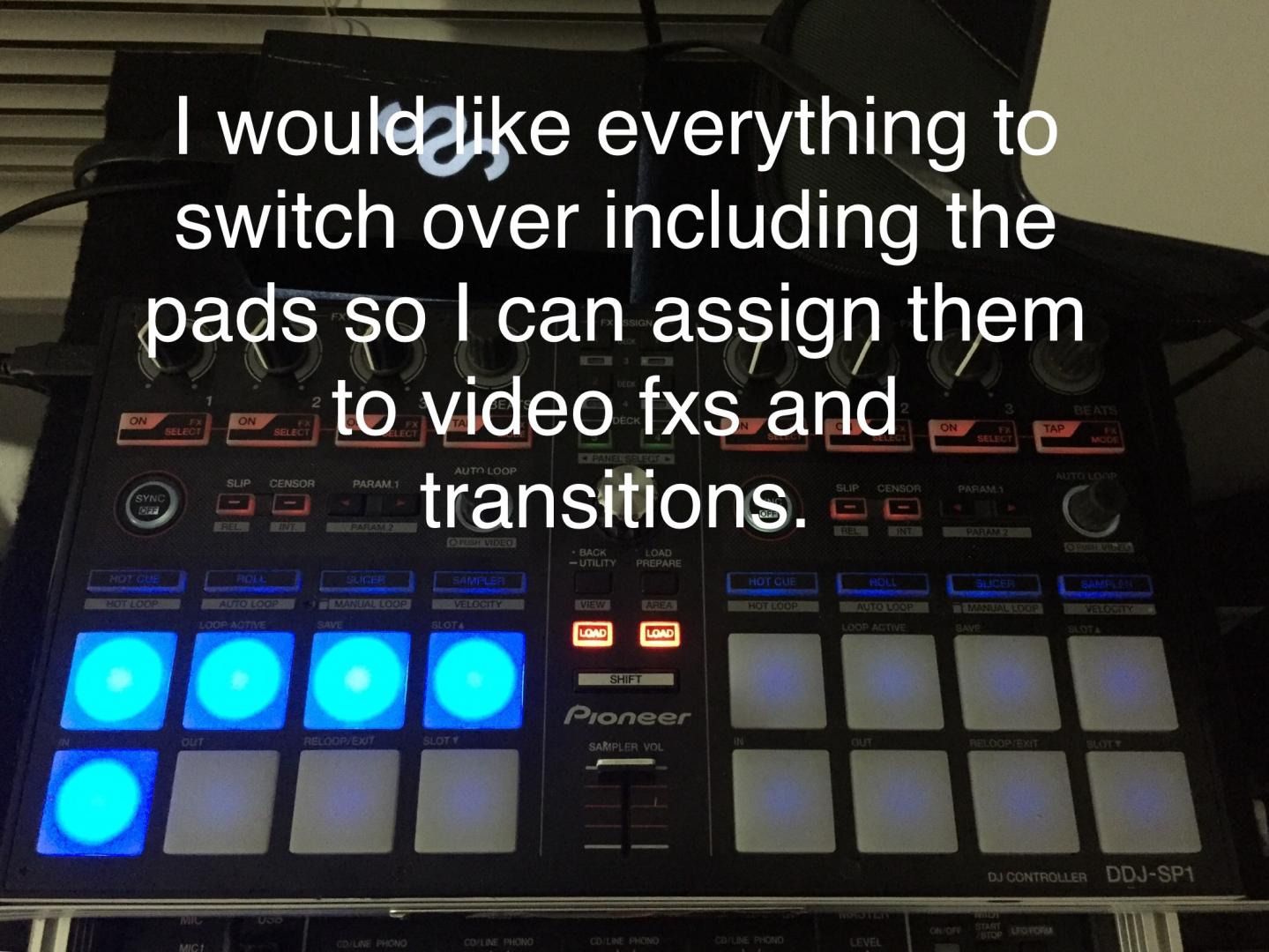

Ok so I’ve been trying to remap the video section of my DDJ-SP1 but I’ve failed miserably every time , ugh!!
So as of right now when I hold down shift and press the auto loop button the top eight buttons and the top eight rotary knobs all affect video aspects of VDJ. This is all fine and what I want.
What I would like is for all 16 pads to switch over as well and become blank until I assigned them either to a video effect or video transition.
Please can one of the mapping gods help me??

Or how about this, it might be easier.
When ever I switch to video mode holding down shift and pressing the auto loop button a special video effect and video transition pad page show up on each side of the DDJ-SP1 but when I hold down shift and press the auto loop button to exit video mode it switches the pads back to the hot cue pads??
EDIT
Ok I got the pad pages made up.
So now I just need help with the script where I hold down shift and press the auto loop button and it switches the pad pages to my new video transition and video affect pages. And then when I hold down shift and press the auto loop button again it switches my pad pages back to my Hot cue pads.
Any assistance is greatly appreciated .
EDIT
