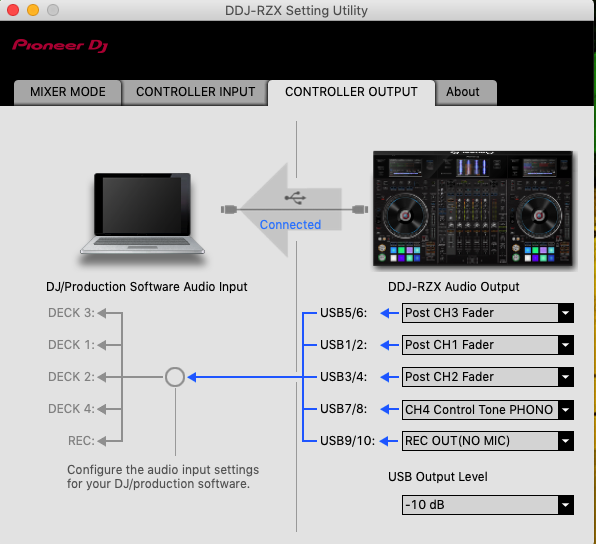

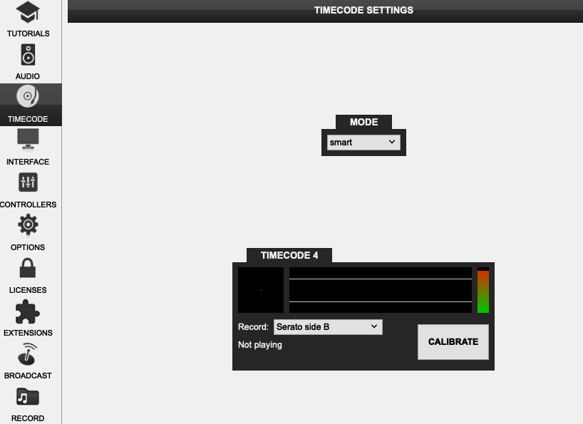

Not sure if its Mojave update on OSX or latest VDJ early update. Tried rolling back but it seems FUBAR. It worked before, on channel 4 set to 7/8. I have tried all the obvious. I can hear the whine from the vinyl, and see signal on RZX, but on timecode settings mode, I just can't get it calibrated, just says no signal. Any ideas please?

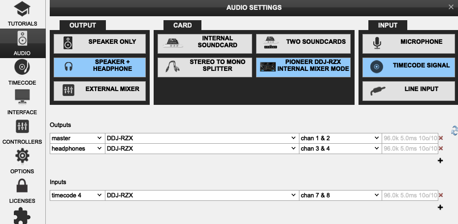

What if you add all 4 timecode inputs in Audio Setup (from timecode 1 to timecode 4) ? Do you get TC signal from any TC input in TIMECODE tab of Settings ?
Do you have the SOURCE Input Selectors to USB ?
Posted Mon 03 Dec 18 @ 10:18 am
Yes. I tried adding the TC sources to other channels and swapping it around, and all set to USB. (Briefly switched to phono mode to make sure the signal was being transmitted, then tried rekordboxDJ, and it works fine in that software)
