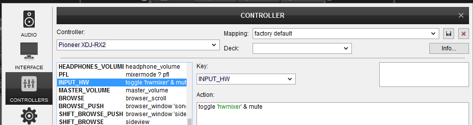

Looking at the mapping, you could try removing "& mute" from the input_hw mapping
Then it will be the same as how the the XDJ-RX is mapped

hi guys,
went into the script and removed the 'mute' so working as would like it.
