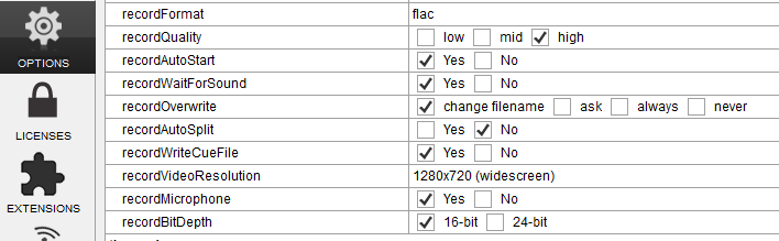

Playing a sample does not start recording with the following settings enabled.

i am not clicking record ... I have Auto Start Recording enabled
if it's not intended to work that way ...
Posted Wed 29 Aug 18 @ 10:19 am
AdionPRO InfinityCTOMember since 2006
recordAutoStart indeed only works by pressing play on a deck.
From the help on this option:
Quote :
The recording will automatically start as soon as you press play on a deck
Posted Wed 29 Aug 18 @ 10:23 am
thanks for clarification.
