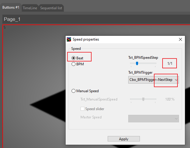

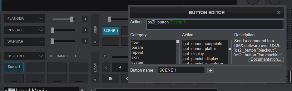

Make sure you run the latest Patch .. https://thelightingcontroller.com/viewtopic.php?f=85&t=3438
You dont have to do anything else in order to control your scenes with VirtualDJ, other than using the action ..
os2l_button 'TheNameOfTheScene'
Here is a very useful Tool to pass your scenes to a Pads page or some popular multi-pads controller mapping
https://www.virtualdj.com/plugins/index.html?category=other&search=os2l
Note: Right-click on your Live buttons in ShowXpress and select Speed Properties->Beat
For creating a show per Track, yes you will need to use the POI Editor and the same actions as above, but for generic/manual purpose, there is no need to.
Made a WIKI page for TheLightingController (Sweetlight, ShowXPress, QuickDMX) https://www.virtualdj.com/wiki/TheLightingController%20with%20OS2L.html

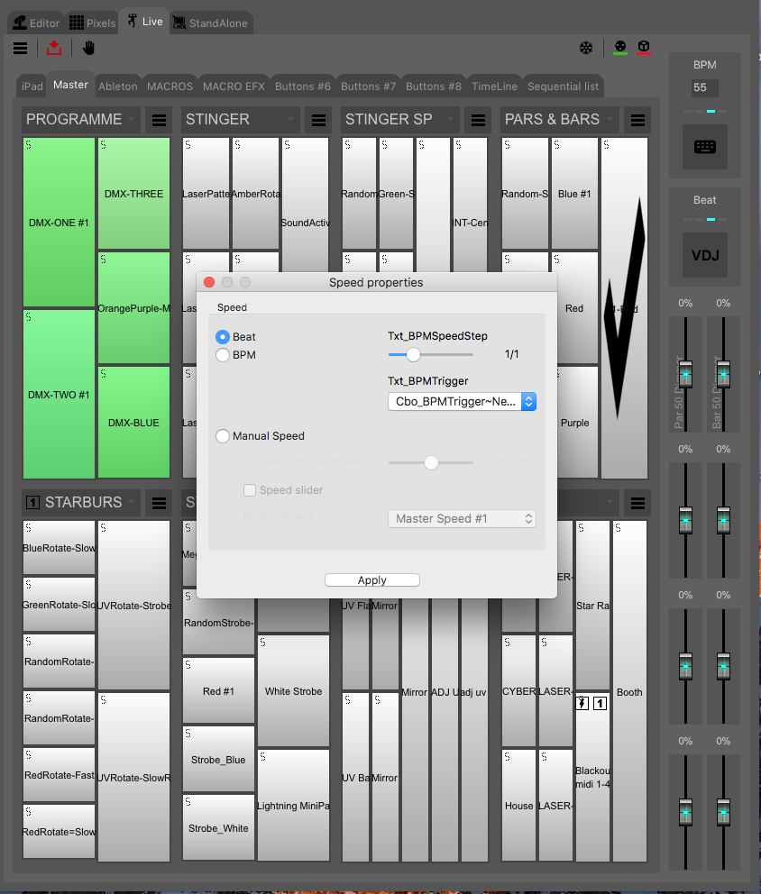

Hello DjDad.. :)
Thanks very much for the reply and resources.
I downloaded the V9 yesterday, and added the "fix" today.
However, I must be misunderstanding... I can't get it to work yet.
Does the button need to have multiple steps?
For example, DMX-1 in the top left (image attached) is a multi-step... the one on the right with the checkmark is a single red LED element. I am assuming as you pointed out, all I need do - is right-click on a button and change to BEAT.... (in image), then playing any song should trigger the light to flash?
Thanks again for your help. Once I get it fired up, I will have a look at your other link.
Posted Sun 22 Nov 20 @ 1:10 am

Thanks again for your response and the link... I don't wish to wear out my welcome with your time, but quickly...I am confused by the VDJ functionality.
1. Is there a difference between the OS2l button and the "regular" lighting control buttons.... the buttons I have in the image?
2. Do I need to create some kind of button/trigger with OS2l in VDJ first?
3. My current understanding is to just right-click on any existing button (image) and change the Speed Properties to BEAT and Trigger Step by Step.
If it is Speed Properties, from your lighting controller forum link - I can see I may have issues with the timing of the steps.
Again, really appreciate your time, thank you.
Posted Sun 22 Nov 20 @ 7:16 pm

* For those following this thread - this was the answer from the link above:
We suggest this setting for the required effect:
- 2 steps only in the scene
- step #1 "on" with short duration (0,2 sec for instance)
- step #2 "off" with duration 1 sec for instance (not really important because of "pause at end" option)
- speed set to 1/1 (1/4 means play 4 times the scene between 2 Beats)
And 4/1 means play the scene one time after 4 Beats.
