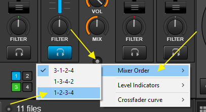

Switch to the 4 Decks default skin.
Click on the Mixer Options, right above Crossfader and choose a different Mixer Order (e.g. 1-2-3-4)

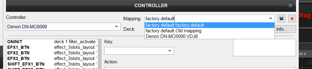

After the update, my mc6000mk2 faders went bonkers. The alignment makes no sense and I've tried almost every combination. I know what I want them to be, and they used to be that way for a few years. 1 & 2 in the center, 3 & 4 on the outside. Now the right play button starts the left player, and the faders are not controlling the correct ones. It's crazy. Can I reload the mc6000mk2 map?
Posted Tue 01 May 18 @ 9:55 am
You can reset by selecting "factory default" in the mappers list.
Sounds like a hardware fault though. I have seen similar things to this happen a few times now and it's the main PCB that has gone wacky unfortunately.
Posted Tue 01 May 18 @ 10:25 am
amarillodj wrote :
...Now the right play button starts the left player, ..
In VirtualDJ Settings-->Controllers tab, select the Denon MC6k from the left-side list. What do you see in "Deck" at the right side ?
Normally you should see "Automatic (Left, Right)" or "Automatic (1,2 or 1,2,3,4)"
