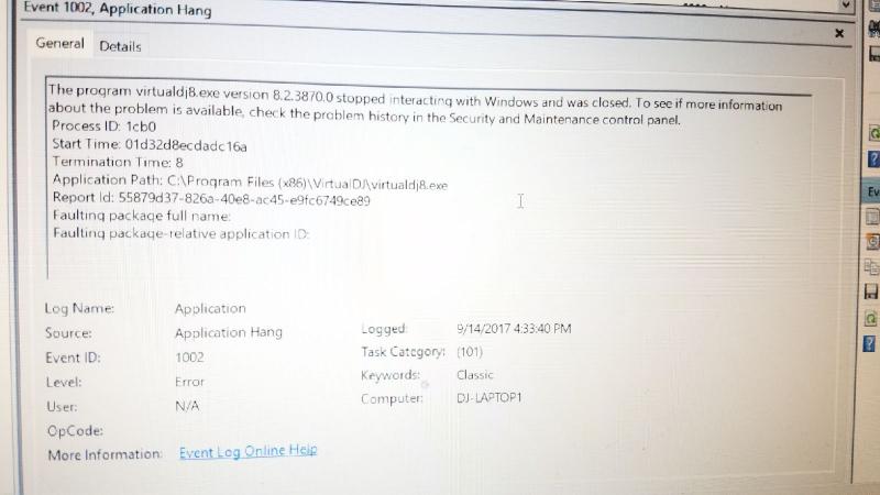

I am running VDJ 8.2B3870 on Windows 10 Pro x64.
As of two weeks ago, it is now crashing on a regular basis. I have never had a problem in YEARS of running this program. I can put on music, walk away, and without anyone touching anything, all of a sudden, the program will freeze (says Not Responding), and I get the spinning wheel of death. The music stops cold. The only way to recover is to end the task from task manager, and reboot the computer.
My DJ laptops are not connected to the internet ever when they are at gigs. They have all the latest Windows patches.
Please help. Would appreciate any advice or suggestions. I HAVE TO TRUST this laptop/software. I can't have a hard crash during a key moment at a wedding!

If you let it be online for a short while, and a crash happens, a crash report should get send to Atomix
Then they can look into exactly what goes wrong on your laptop

I looked for CrashGuard, and couldn't find anything in the VDJ8 folder in terms of any log file.
The manual says that if the program hangs, and there's a crash guard button, you can click it for more info or something, but this is a hard crash. No error menu's, just a giant FU.

Exactly. Crash guards only kicks in if it's a real crash. So you should probably create a ticket asking support if they received a crash report from you

If VDJ is hung up (spinning wheel) it is not likely a crash report is sent. If VDJ knew that it crashed it would have probably rebooted itself and not remain hung. Detail the steps that causes it to hang if you can... Start real simple with like nothing running and then add more activity until you can cause the problem. Sometimes that takes persistence on your part. I can cause it to hang or crash in a couple ways but takes some steps and don't want to confuse the issue for you as it is probably unrelated to your case.
