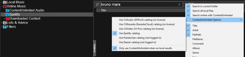

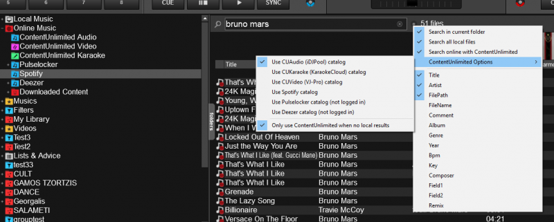

Here is what i get ..

Thanks for the suggestion, but it didn't seem to help.
Here's what I see:
Here's what I see:
