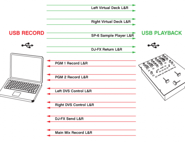

A special button is not offered because the unit is not officially supported, so no mapping files and no pre-defined Audo setup.
You will have to manually create the following...
deck 1 ... Rane ASIO .. Chans 1,2
deck 2 ... Rane ASIO ... Chans 3,4
sampler .. Rane ASIO .. Chans 5,6 (optional)
timecode 1 .. Rane ASIO .. Chans 5,6
timecode 2.. Rane ASIO .. Chans 7,8
record .. Rane ASIO ... Chans 11,12 (to record your mix)
Some Tips...
- Make sure the swithers of the Analog Inputs at the rear side are set to PH (Phono) if you are using turntables.
- Make sure the SOURCE/PGM selectors at the top are set to USB , or else you will hear the timecode signal instead of the track's audio
- Try all 4 analog Inputs, not sure which ones need to be used.

tested it today,,,,and nothing from the timecode with it set to all inputs....i tried 1.2, 3,4. 5,6. 7,8
was using a single timecode so also tried tc 1.2.3. and 4 with nothing....vdj was not receivin the tc signal. can anyone try this with a 61 and tell me their results!
Posted Mon 20 Feb 17 @ 2:14 am
ok i sorted it out out djdad..everything works fine with your config...sampler goin through the aux(5,6) channel and 2 tc and 1tc both work fine. thanks sir
