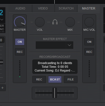

Unfortunately it doesn't. When pressing the BCAST button ('master tab' Pro layout of default skin) it just says "starting broadcast" and "broadcast started" - no duration.
Posted Mon 18 Jan 21 @ 11:55 am
Sorry, looks like it does for shoutcast/icecast, but indeed not for video broadcast.
Posted Mon 18 Jan 21 @ 1:15 pm

I've just noticed this has been rectified in the latest build. Video broadcast now includes run time. Thanks Atomix!
