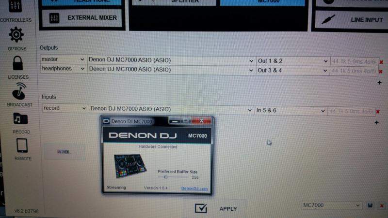

          help :-( my current setup up laptop windows 7, intel core i7, 16mb of ram & 2TB SSD hard drive. two denon SC3900's and American Audio mixer 14MXR been djing with this well over 5 years no problems. just got my brand new Denon Mc7000 tuesday 8-1-17 and tonight ive been testing & practicing (i have a wedding to dj sat) and want to take my new unit... but while mixing & stuff i lost all sound.the lights are still going around the platters, jog wheels on the skin are still moving & tyme remain/ elapsed is still counting down... but no sound coming out of my speaker.. all lever meters are showing music signal but not even sound out of my headphones... so i closed out VDJ and rebooted it and picked a song and all is  back to normal... but now im scared to dj with it sat cant have music just cut out at a wedding.. please advise thanx
    Posted Thu 03 Aug 17 @ 5:18 am
          here are my settings ? will changing the preferred buffer size & or skin fps from 30 to 60 help with my issue ?
       Posted Thu 03 Aug 17 @ 12:22 pm
