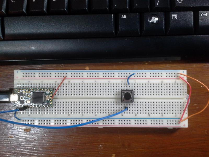

I'm trying to prove that it's possible to create a controller for VirtualDJ 8 using the Teensy 3.2. At the moment I have a single pushbutton that I want to use to trigger a hot_cue via MIDI. Everything appears to be fine except that VDJ does not respond to the button.
Setup:

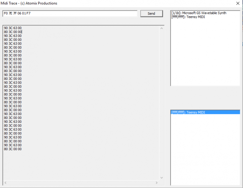

The Teensy will act very happily as a USB-Midi device. I'm using the sketch from this page to send simple noteOn/noteOff messages via USB http://theamateurmaker.com/simple-midi-controller-single-button/ The messages are being sent perfectly according to MIDI Trace, and in Cubase it plays the note C4 with no issues.

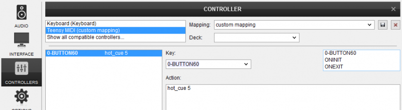

The button appears in VDJ's Controller mapping section as 0-BUTTON60 when I press it. I have mapped it to 'hot_cue 5':
However, the hot cue does not work when I push the button. VDJ does not seem to respond to the button at all.

There is a strong chance that your definition is not taken, so its probably still "Simple Midi"
What happens if you rename the button e.g.
from
<button note="0x3C" name="0-BUTTON60" deck="1"/>
to
<button note="0x3C" name="MYBUTTON" deck="1"/>
do you get the "MYBUTTON" in the Key Learn ?
Also, you will need to manually create a very basic (empty) mapping xml file using the device name
<mapper device="Teensy MIDI" .... >
</mapper>

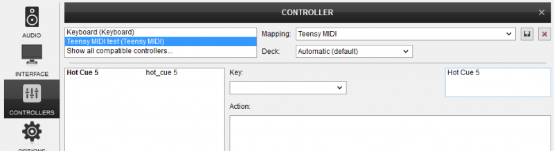

DJDad, you were absolutely right - my definition wasn't working because it was a .txt. not an .xml ... rookie mistake! Hence it was creating a Simple Midi mapping. I fixed the definition and created an empty mapper for "Teensy MIDI".
I can now rename the controller and button and see the changes appear in VDJ
However, still no response from the hot cue :( Anything else I might have missed?

your button works as momentary (value on down and 00 on up) or toggle ?
i also see it sends 63 instead of 7F on down so try adding value="0x63" to the <button
Did you try naming the button without spaces ?
did you try other actions other than hot_cue ?

Still no joy despite all your ideas!
It's a momentary switch.
I fixed the velocity issue: the code was sending 99 instead of 127 (presumably for use with synthesisers etc).
I have renamed the button "HotCue5".
I tried remapping it to "play_pause", "pfl" and "eq_kill_low" but to no avail. The mapping file updated each time.
Thank you so much for being patient about this! Is there anything else that might be getting in the way?
(Incidentally, if I run Midi Trace when VDJ is open, I see no messages. If I close VDJ messages start coming through again. Don't know if this is normal or relevant.)
